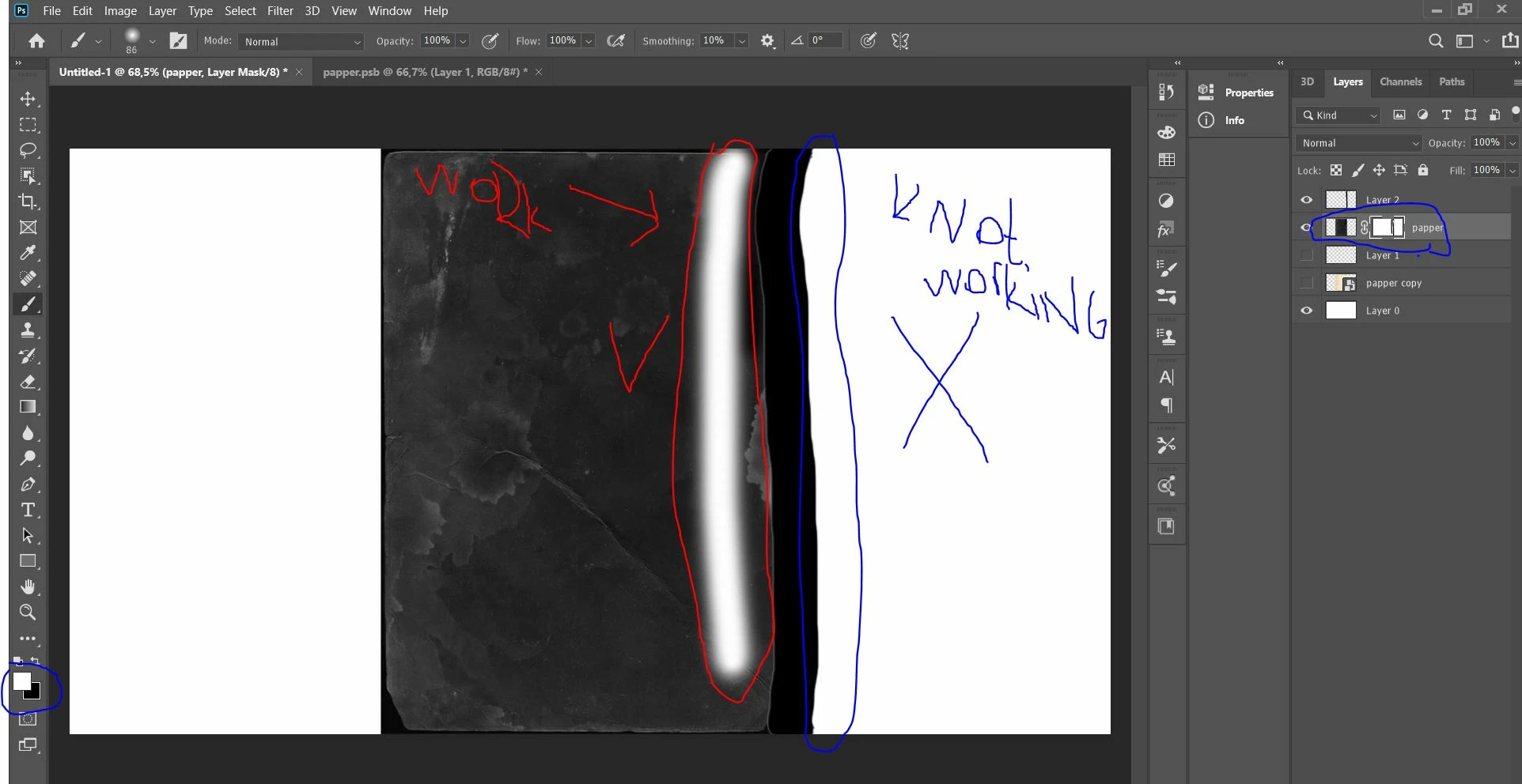

I have done an photo last week and when i did the steps it worked. i do an new layer like in the video, then i draw with an brush. Then i select the brush stroke. then i add an vector mask to the paper and click ctrl i. When i try to brush id dosent work. I can only brush away the paper or i can brush the inside of the brush stroke. But not outside. Pls help me this is the video im talking about.
https://youtu.be/egh4SvwUxlk?t=3875 it only show i the layer mask that i brush away but it dosent show on the actual page. Need help now! i Have restarted all setting

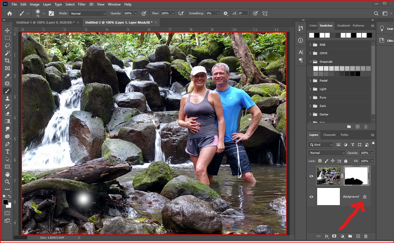

EnigmaJeff
July 6, 2020
My Issue: working with a new image pasted from clipboard (so background was white).  I would apply a mask layer and start painting with black...I would get a brush-sized dot but the rest of my brushed mask looked like it was doing nothing. In my Layers panel, my whole mask appeared, just not the image.
My Solution: unlock "Background" layer.
Inserted image below is BEFORE unlocking. You can see the dot (lower left under log) as compared to my Layers mask thumb. Simply unlocking displayed my working mask instantly (no screen shot of that).
December 4, 2019
horungaaar
Having looked at your screen shot - if you want to mask the stroke (Layer 2), you will need to add a mask to Layer 2. The mask on the papper layer only affects the art on that layer.
Another option would be to group the two layers, and then add a mask to the group.

JohanElzenga
December 4, 2019
Another thing to check: Do you have an active selection perhaps? That selection could be hidden if you pressed Cmd-H, so make sure that is not the case (look at the 'View - Extras' menu. Make sure it has a checkmark). If there is an active selection, then all tools only work inside that selection.

JohanElzenga
December 4, 2019
See my comment right below the screenshot. Your screenshot makes it impossible to see exactly where the black stripe of that second layer is positioned. If it is positioned right below the area you are trying to mask, then that explains why you do not see any effect. You paint in the mask to reveal what is below the top layer, but if that is the same as what is on the top layer (both black), then you won't see any effect. Temporarily turn off that second layer from the top to see if that helps making clear what happens.
-- Johan W. Elzenga
JohanElzenga
December 3, 2019
It's a bit difficult to see, but you have another layer on top of the layer with the mask. That other layer won't be masked, so its content will remain visible no matter what you paint in the mask below.
-- Johan W. Elzenga
December 3, 2019
Okay so i should put the layer below?

JJMack
December 3, 2019
What are you brushing on? You can not brush on a Vector Layer mask.  You need to user vector tools on vector mask.
