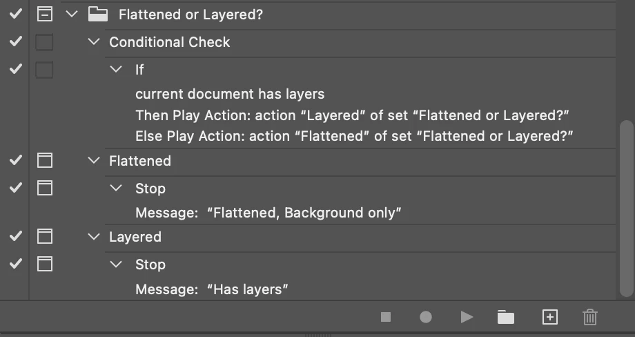

1) There is a conditional action to check for whether an image has layers (1 or more) or is flattened with a special Background layer, which technically is a single layer, but this may not meet your criteria?
2) Conditional actions don't include paths, so you would need a script for this one anyway.
It is easy enough to script a warning/alert when opening a document (Script Events Manager ) if it contains > 1 layer or path, however, if you want automation to actually "do something" then more info would be required.
