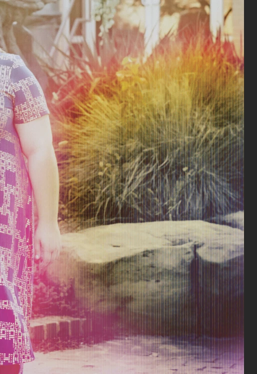

    This is a very tricky thing to do and its going to take a lot of work and finesse to do that.  D Fosse is right on the money about how to get this right.  But even then,  you're going to have to do something to bring color back in the area shown in his photo.

    D Fosse
    October 1, 2018
    This is really difficult, because there is no color information left in the pink area. There's nothing to restore, you'll have to rebuild.
    That's not to say it's impossible, nothing ever is, only that it will take time. I'd start by desaturating the affected area and rebuild the color using gradient map layers, applied locally with soft masks. You'll need a lot of layers, each masked to a local area.
    I played with it a bit just to see what could be done. This is not finished, but about at the point where you could start recoloring. I'm already up to 10 or 12 layers here, each masked, so there's no point in showing that.
    If it is an important image, get someone who's good at this. It can be done.
    Or of course, just turn it into a black and white.
