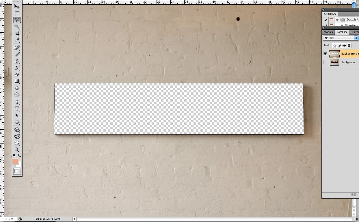

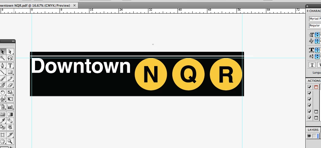

Each PDF is a single image and all are identical in size, which should make any actions easy.  I'm attaching a screenshot of the photo image I've prepared, which should be a mask for the incoming PDF image.
I've also attached a screenshot of one of the incoming images, as seen in illustrator.  (There are a few hundred of these, all subway signs, all the same size.  And artboards match image.)
Each one needs to be imported and skewed slightly to match the perspective in the photo.  I could do that separately as an action, but I want to make sure it's easy to import all the resulting images correctly into the photo.  Alignment is key.  Can do these nicely one at a time, but obvs that will take forever.

With »skew« do you really mean Skew or Free Transform/Perspective?
Either way I would recommend creating a template file with the Illustrator-file placed as a Smart Object (in case of Free Transform a Smart Object in a Smart Object).
Then use File.openDialog to select the files and have a for-clause work through the lot, replacing the SO’s content and saving off the jpgs.
