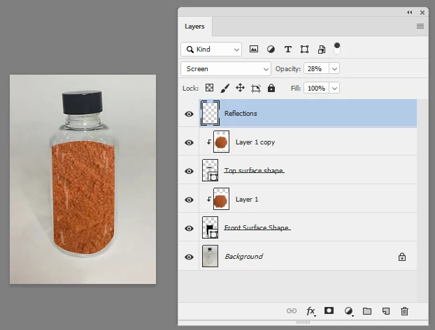

I'm relatively new to photoshop and I need to fill an empty bottle with spice mix and I'm at a roadblock.
Could someone please help me in letting me know how to put the spice mix or any other mixture into a clear plastic box which can be used in product advertising.

Hi
Use masking to make the contents into a cylinder shape then paint some reflections on top.
So here I made a shape for the front surface and a shape for the top.
Then I clipped the powder layer to each (Alt - click on border in layers panel)
Finally I brushed on a few "reflections" onto an empty layer set to "screen" blend mode
Dave
