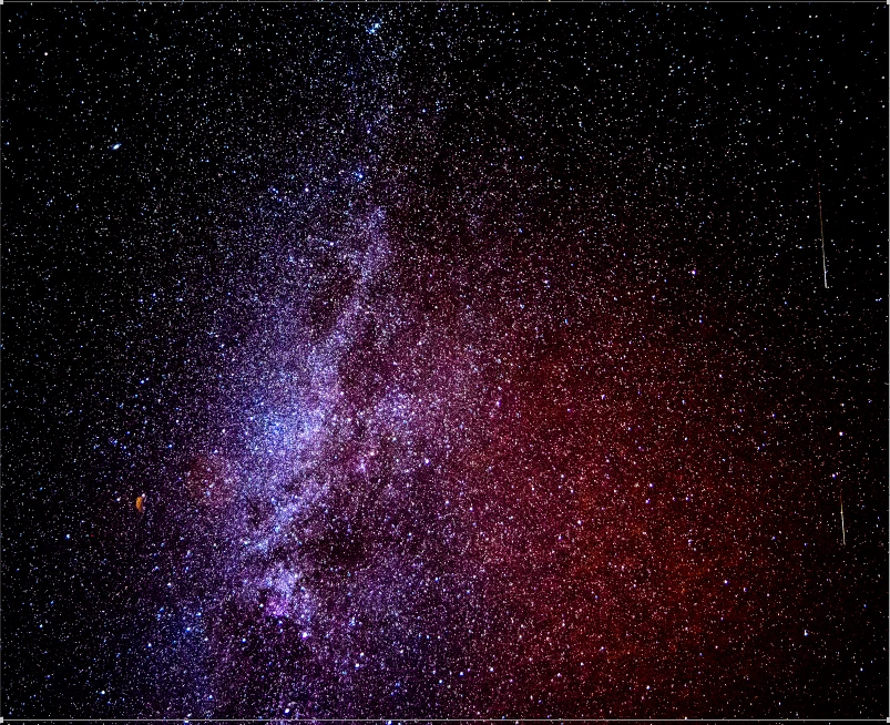

On CC2017.0.1 the cmd+opt+Shift+E command has stopped working on my iMac.  When I use the command it still places a new layer above the visible layers below, but it does not reflect all the edits applied.  More often than not the new layer is a copy of the background layer.  I get the same results with the merge visible and flatten image commands.  Anyone else having this problem?  Any way to fix it?
    jml2035Author
    February 2, 2017
    After playing around with some images I have found that my problem is related to Levels adjustment layers.  The problem appears I apply a Levels adjustment then try to flatten the image or generate a new layer from visible.  The levels adjustment either doesn't render at all or incompletely (similar to a lower opacity).  This does not occur with any of the other adjustment layer options.  Interestingly I  can use Curves to apply similar edits attempted in Levels without problem.  I have included a couple screen shots, one with the layer stack active (bottom) and the other with the layer stack flattened (top).  I will report this to Adobe.

    Hi
    Are both your before and after screenshots at 100% zoom?
    As mentioned in my earlier post, any other zoom is blended using 8 bit previews, and star fields are one of the image types that does show that difference.
    Dave
    jml2035Author
    February 2, 2017
    Yes still occurs at 100%.  Not as big a difference but still noticeable especially full sized on a calibrated monitor.  Here are two screenshots of the same rectangle at 100%.  Final prints show the difference also .
    Rafael Aviles
    February 1, 2017
    Make sure you have the top-most layer active when you use the command. The new layer command makes the new layer from the active layer and all the layers below it.
    davescm
    February 1, 2017
    Hi
    I don't see that here - it appears to work correctly on Windows 10
    One caveat though - and this is very image dependant. Are you viewing at 100% before and after? You will sometimes see a difference due to the way zooming out uses previews at any zoom less than 100%. How different depends very much on the image and the adjustments and blending modes - usually it is not noticeable but occasionally it is very visible.
    Dave
    jml2035Author
    February 2, 2017
    Thanks for your reply.  I have added a couple screen shots of my problem to the topic.
