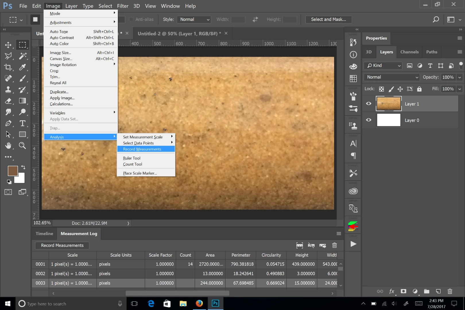

    Chuck Uebele
    July 28, 2017
    If the charcoal is just the dark spots, you would want to isolate the sample from the rest of the image. Then use color range to target the dark areas of the sample to make a selection. Once you have a selection, you can use analysis to get the area of the selections. You can then figure out a percentage from that:

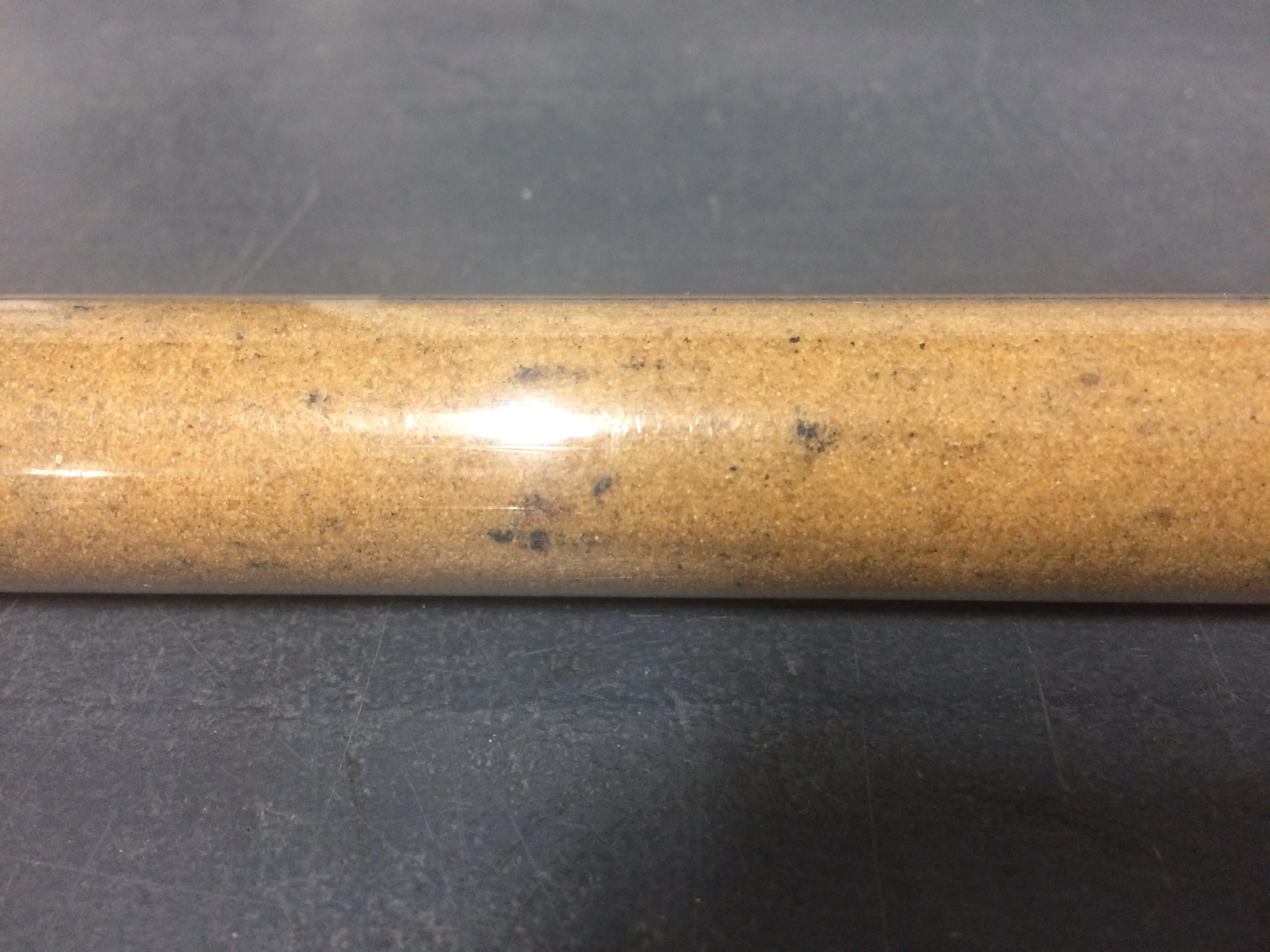

    sjamis
    sjamisAuthor
    July 27, 2017
    the really dark bits are charcoal
    Norman Sanders
    July 27, 2017
    The photograph poses several problems and for you to have any chance of success, it must be reshot. The image is unevenly lit, has a glaring hot spot without any information, has inadequate depth of field and lacks sharp focus. It requires shadowless lighting, a yellow/orange filter (Perhaps a Wratten No. 15) to enhance contrast and adequate depth of field that encompasses the entire core depth, plus a white background and absolutely crisp focus. With sufficient file size and resolution plus added contrast via Photoshop we may be able to isolate the fine grains appearing in the core. This image is not suited for the job. Sorry.
