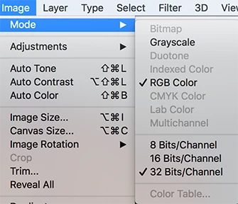

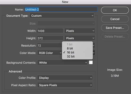

Dave is correct. 32 bit channel has been selected. When you create a new document choose 8 bit or 16 bit:
If you open the problem document and choose Image>Mode>16 bit or 8 bit. You will fix it.

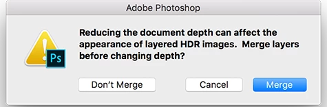

Remember if you have layers make sure you keep them by choosing Don't Merge.
