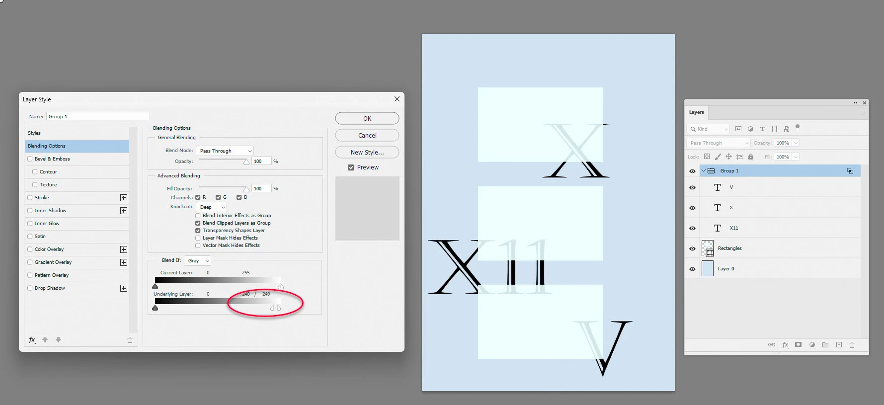

davescm
August 9, 2023
An alternative method is to put the text into a group then use the Blend If sliders in Blending options to get the transparency on the lighter areas only. Hold down Alt to split the sliders and adjust the transparency balance between the dark and light areas.
All elements can be moved independently
Dave

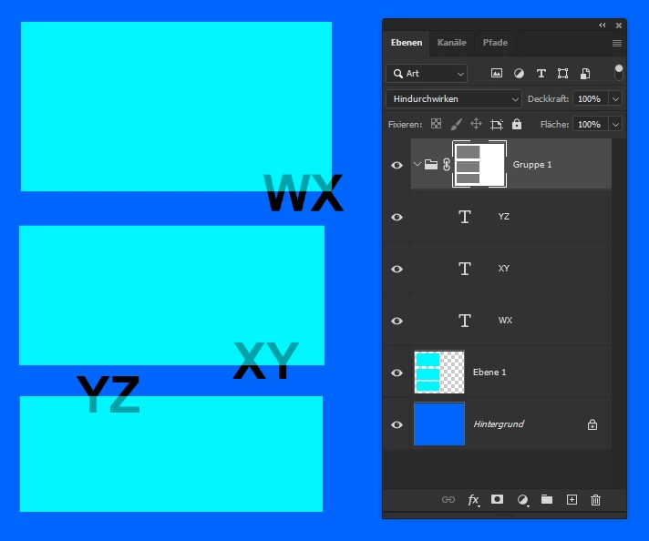

pixxxelschubser
July 26, 2023
If I understand you right - it may be I would do something like that:
Text layers can still be edited and moved - the area and the strength of the opacity are defined by the layer mask of the group.

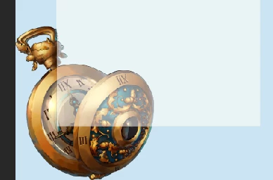

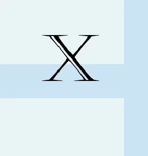

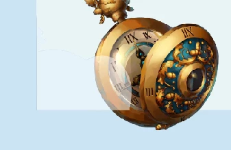

this is a photo to show you what I mean. Now the X is on top of all the layers. I want to be able to see the x true the light blue box, like the x is behind the box without making the whole box transparant. On the photo below I have done something like that with a bigger picture.
But when I move the compass, the transparancy does not follow. Than this is the result. The part of the rectangle where the compass was before, stay transparant becaus that is how I done this for this picture. But on the now place where I put the compass, there is no transparancy because I put the transparancy on the rectangle.
My question is (for the letter X), can I use transparancy on a surtain way on the X, so that when the letter is partially behind a rectangle, you can see the letter true the rectangle without making the whole rectangle transparant? BUT if I move the X, the transparancy follows? SO if it stays on it's place, I know how tho fix it. But I want to be able to move around with the letters to adjust if I make changes to the design.
