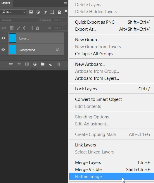

    barbara_a7746676
    December 30, 2017
    You could combine the two layers into a single layer.
    In the Layers panel menu, Merge Layers, Merge Visible or Flatten Image.
