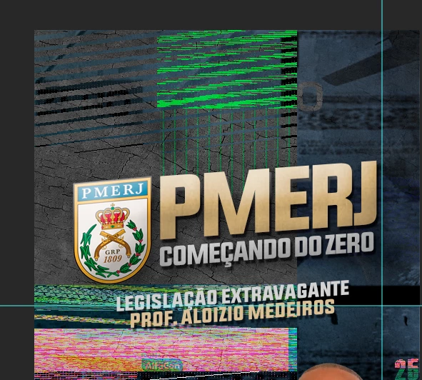

estava alguns bons meses sem atualizar o PS justamente para correr de possiveis novos bugs, atualizei esses dias e já tem um me incomodando muito, as vezes quando estou utilizando a ferramenta de texto, tá dando alguns bugs gráficos na imagem, segue print do exemplo:
Após dar enter e finalizar a edição do texto, volta ao normal... alguem sabe o que pode estar ocasionando isto?

Hello @AxelMatt ! Thank you very much for your help, I changed the driver and performance improved a lot, the bug I mentioned still appears rarely, let's say the problem was 95% solved... (the fps in the games didn't get worse, I think it stayed the same thing)

Can you post content of Help > System Info?

@pmzstudio more than likely it's a GPU related issue, what kind of GPU do you have in your system and is the driver up to date
