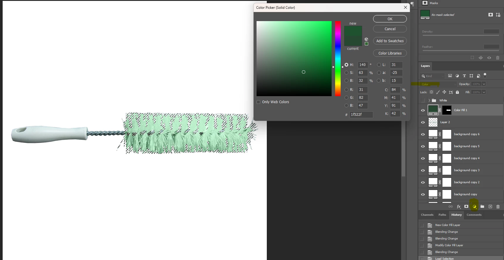

I am trying to change the color of an object, in this case a bottle brush, but any object I use it happends. I will high light the part of the object and select the Color Fill tool and pick the color I would like it to be. However, whenever I click okay and then use the drop down box to select 'Color' it changes the color to a mute/dull shade of the color I wanted to use. This happens with every color I try to use and then I have to use a bunch of other tools to get to the color I want, but that sometimes looks bad and I just get frustrated. I'm not exactly a newbie to photoshop but I'm absolutely no expert so any advice would be great!

It's working correctly. You just misunderstand what Color mode means.
This is the right color, but it has to preserve the underlying tonality. If it didn't, it would just be a patch of flat color; just an ordinary fill. What you need to do if you want the object itself to have that dark green color natively, is to lower the luminosity as well. You basically need to remap the whole tone curve.
"Color" has a slightly narrower meaning in digital imaging than it has in everyday casual speech.

Ahh okay. I don't think I have done it like that before but I will definitely try it that way! Thank you for your response and help.
c.pfaffenbichler
May 9, 2024
Put the Solid Color Layer in a Group and move the Layer Mask to the Group.
Then add a Curves Layer underneath the Solid Color Layer to edit the luminance of the affected region.
As @D Fosse indicated »Color« indicates the combination of Hue and Saturation here, the Luminosity is a third property.

Oh okay. So I have not been using the tool correctly for this situation. Thank you for informing me and responding!
D Fosse
May 9, 2024
Well, strictly speaking, you have used the tool correctly - but it's the wrong tool for the job. It doesn't do what you need, not by itself. You need something that will bring the luminance/tonality down in addition.
