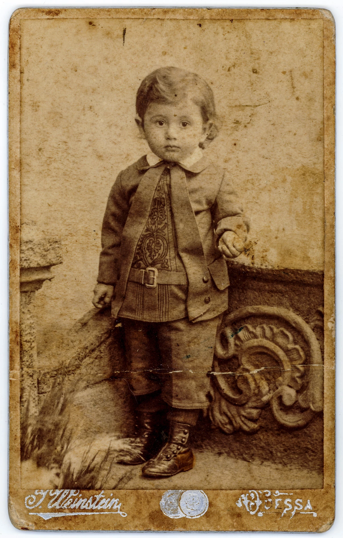

    Dear All,
    Thank you so much for your advices. Here is the photo I want to work on.
    Although I'm not familiar with all the deep Photoshop options, I get help from tutorials and all your advices will help me on that.
    I wish you all a very good day...
    Shlomit
    You haven't mentioned what the intended output will be—composite color printer or offset printing? Your scan obviously has color in it, are you trying to convert the original scan color so that the output is perfectly neutral, or are you trying to reproduce the original color? If the output is offset and you are looking for neutrality, RGB mode will convert to 4-color CMYK, while Grayscale mode will output to the black plate with no CMY.

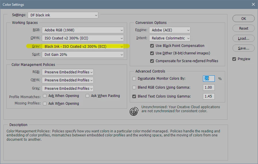

    Yes, and that's a perfect example of the problems you can get with grayscale. You get the CMYK profile's black ink assigned to the data - but that's not the profile used when creating the file. So the tone response curve comes out all wrong.
    Unless you're prepared for that, and set your working gray up accordingly, so that you can assign that to the file and work with that:
