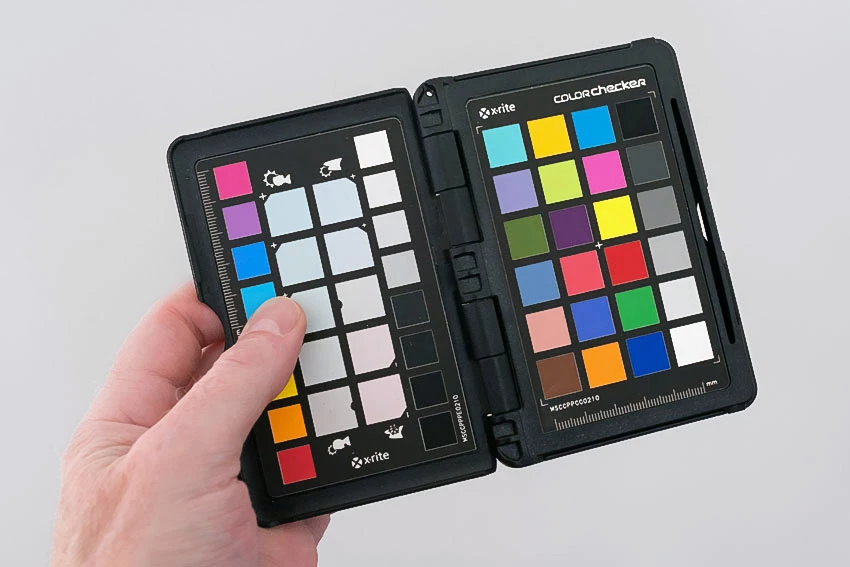

    First of all, you need one of these. Include this in the shot, or a reference shot done at the same time under identical conditions:
    You will never ever get a perfect colorimetric match, meaning a full match in numbers if you took measurements and compared. And even if you did, it wouldn't look right. Any measurement device will "perceive" the original pigments differently than the inks on paper, and different light sources will also influence the perceived color. Look up "metamerism" on Google.
    What you use the colorchecker for is to set the basic tone curve. All these patches, including the neutral ones, have standardized Lab values. This way you set the basic brightness and contrast - but note, it only works on flat surfaces in flat light, not for 3D objects.

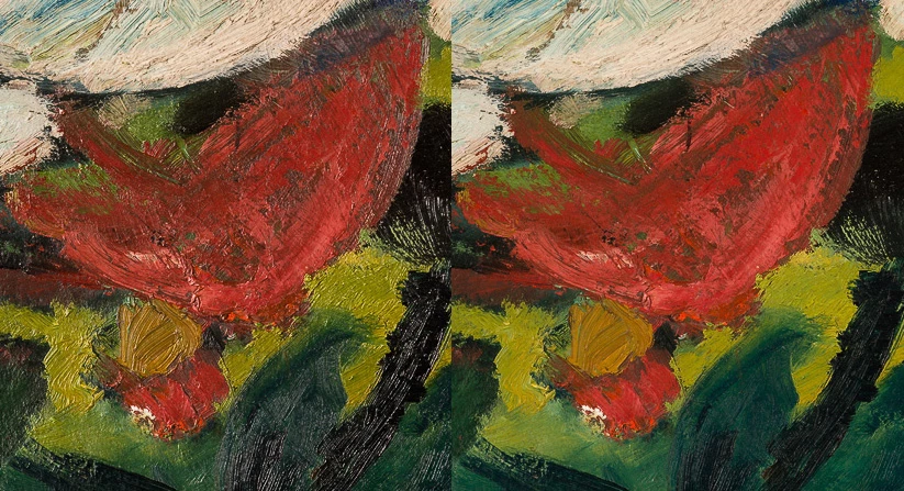

    D Fosse
    June 2, 2018
    Absolutely. As it happens I made a direct comparison a while ago - and this is not even an extreme case, just what happens on "macro-level":
