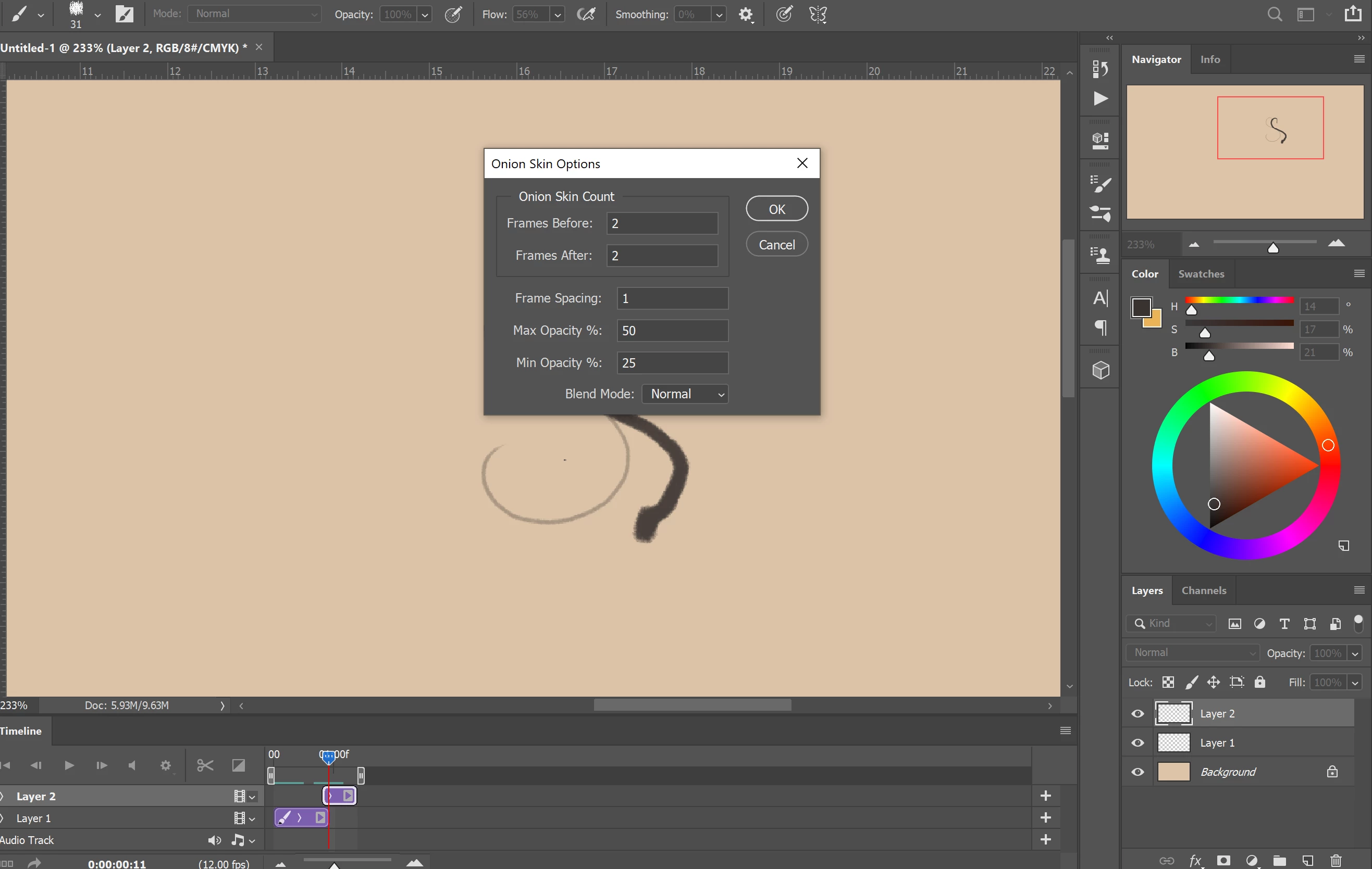

Here are all my settings/set up

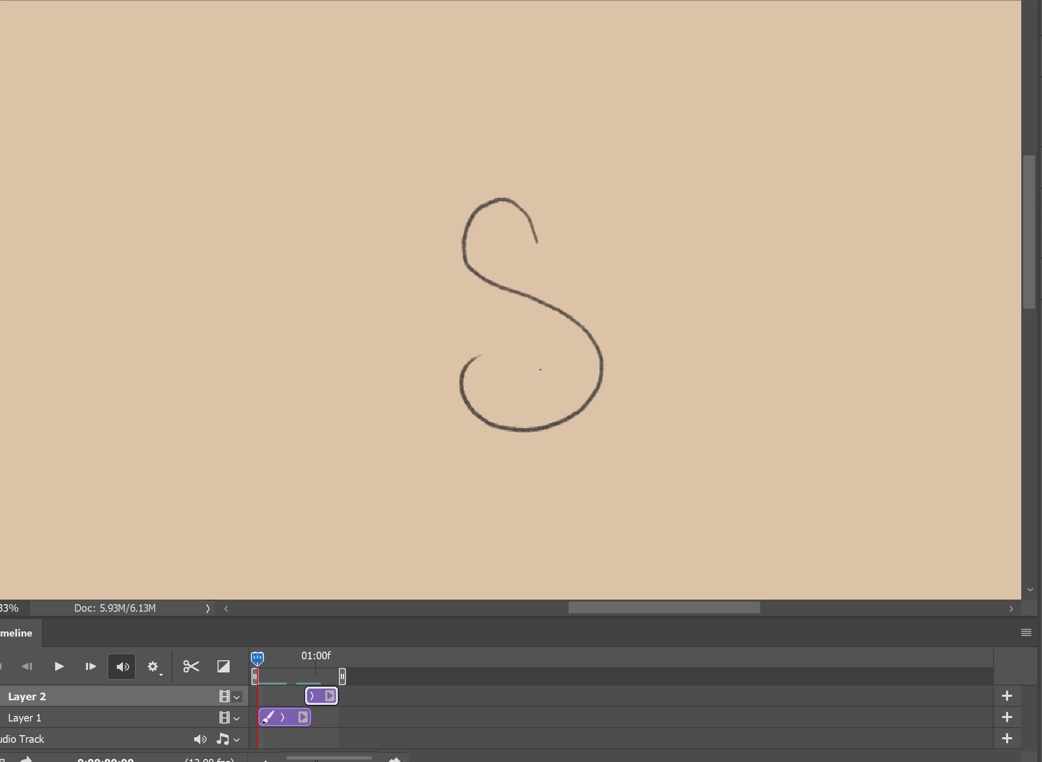

This is before i draw a frame, everything works normally.

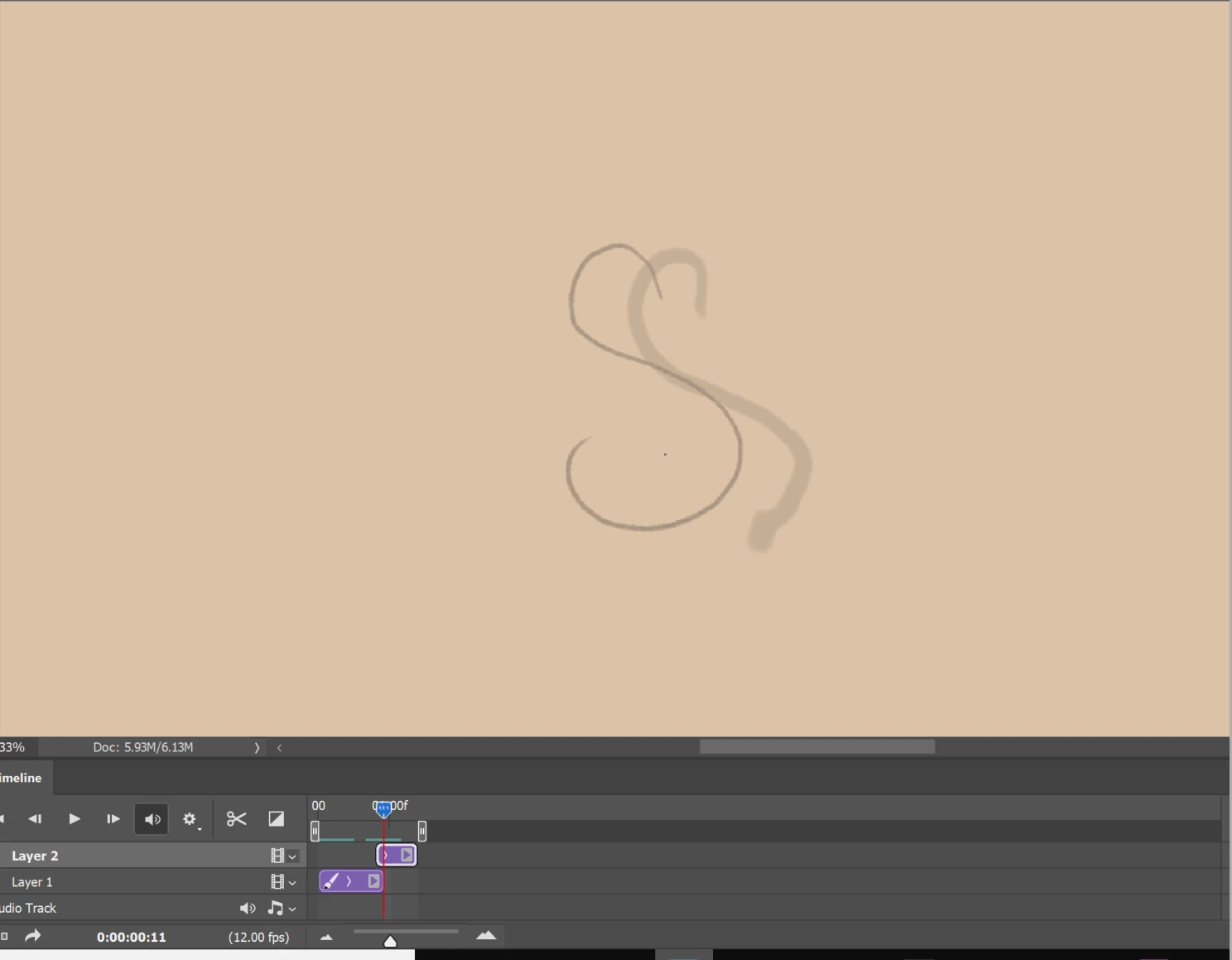

This happens while i'm drawing (The thicker and lighter line is the one i was drawing with

OK I can see what is happening now
Your layers are set to last for more than one video frame which is unusual for use in animation.  With onion skin on and "frames before" and "frames after" set to 2, the image is showing you 5 video frames. While  you are drawing the brushstroke only the brushed layer  frame being drawn is updated - but as soon as you lift the pen then the before and after frames (which in your case are on the same layer)  are updated. This means that any areas of lowered opacity (including soft brush edges) are multiplied  and you see an immediate raising of the opacity.
