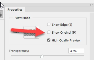

A couple of other things to check , in addition to those mentioned by Barb
1. Make sure "Show original" is not checked at the top right of the select and mask workspace
2. Make sure if you are working on a copy layer that the original layer is not directly below with visibility enabled. In other words onion skin transparency is working but the identical layer below is showing through
Dave
