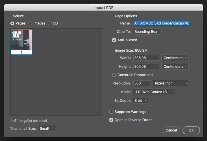

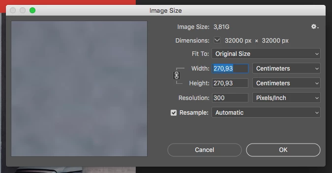

Hello all,
When I open a file (see screenshot 1) the image size is correct, but when I open, the image size is different (screenshot 2)
Is the same file.
How can i resolve this problem?
Best regard
    marliton
    October 4, 2018
    Hi. In the first screenshot, you are opening a PDF, in the second, is an image, two different process event if the original image is the same. When you create a PDF, normally, there is a resampling process, so, is possible that the resolution change. Also, when you open a PDF in Photoshop, there is a rendering process with the resolution that you define in the import PDF window. That means that you can't expect to get the image in Ps with the same size o resolution as the original image.

    You could try creating the image at the intended resolution and size, then placing the pdf.
    Why are you converting a pdf to a pixel image?
    Why do you want a resolution of 300ppi at more than 3m of side lengths?

    In this case I open an .ai file
    c.pfaffenbichler
    October 4, 2018
    Again: Why?
    Presumably the ai file contains vector and type content and that would be degraded by converting them to image pixels.
