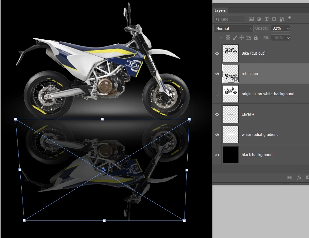

To get a reflection of the bike on a shiny floor rotation tool is used. I do not think image look natural. Because 180 degree rotation takes the back wheel to front & front wheel to back. What is the alternative solution to this issue?
Correct answer Trevor.Dennis
A wee tip:
Make the reflection a Smart Object, and give it a touch of perspective.  Remember that the bike/object has width, and any bit of the reflection is going to be on a line directly between your eye and the coresponding area on the primary object.  It's not arbitrary because the further away your percieved point-of-view, the straighter the reflection would be.

A wee tip:

Thanks for the more refined solution. I can noticed when I see the sunlight shadow of a skyscarper, it is perspective. This is also I can imagine it is perspective to eye. Really it is a excellent enhancement.
Why does makeing reflection a Smart Object?
I am asking following question for curiosity.  If a object is in a 3D model only we can see the opposite site by rotating it. How does Ps do this?
It does not, and that is something that can make it easy to spot a real reflection from a Photoshop inverted image 'reflection', particularly when the object is close to the camera.  As an example, using Trevor's good post above, in a real reflection you would not see the top of the rear tyre but you would see parts of the bottom of the engine and frame that are not visible in the direct view. The only way to achieve those would be:
a. Photograph a real reflection
b. Use a 3D model and render a reflection
c. Paint in the differing view elements - don't underestimate the skill required to do that effectively.
Dave
Semaphoric
October 19, 2023
Use Flip Vertical.
