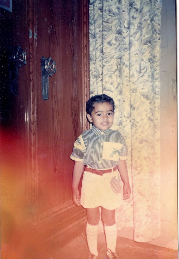

I am unable to remove orange distortion in attached photo. Help needed, thanks in advance.

This distortion is too irregularly shaped to use any kind of automated correction. So I'm afraid you'll need a keen eye and some manual brushing (plus time and precision) to make it appear okay again. It might even require two or three separate color corrections. I'd give Color Balance adjustment layers a try, and use masks for each of the layers, to easily edit them without destroying any original imagery.
Note: some parts in the lower left corner of the image are too heavily affected. There's almost no nuance left in these areas, so you won't be able to restore any original details.

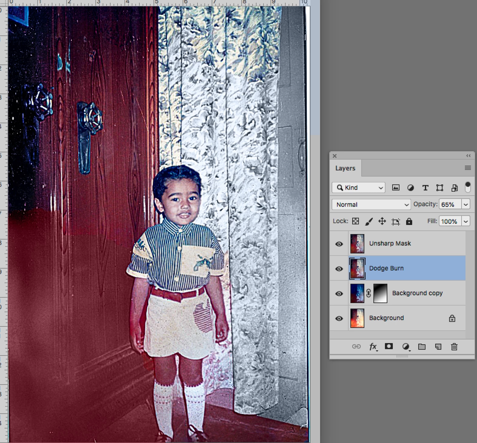

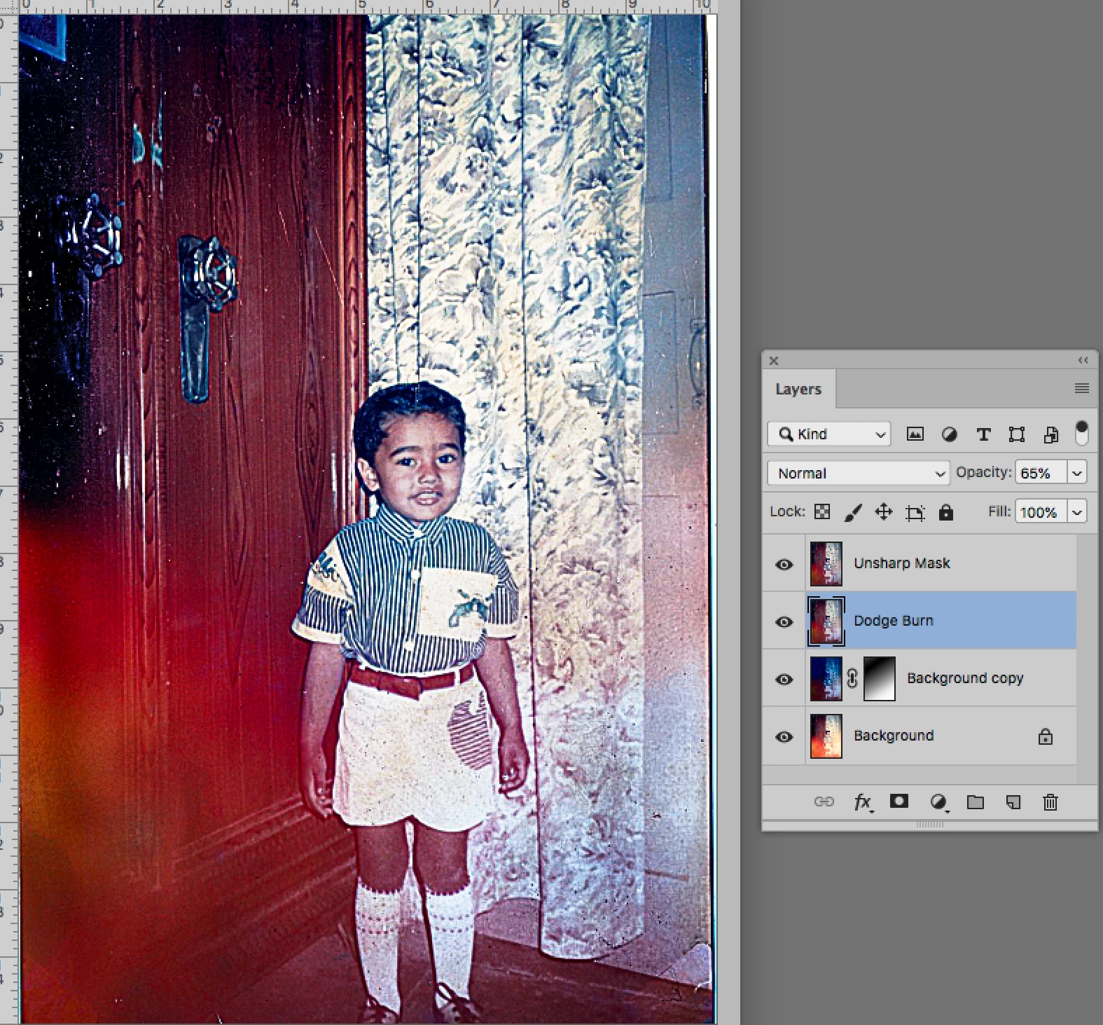

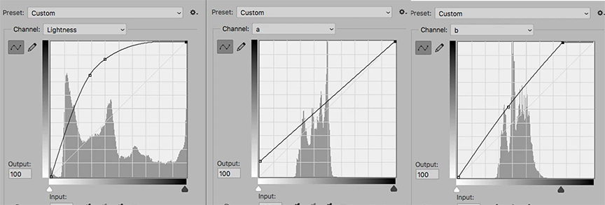

Lab Color, Gradation Mask and the Curves shown above. Dodge and Burb right and left side. Unsharp Mask. Re turn to RGB
At this point additional color adjustment and local dodge and burn are needed but I hope this gets you started.
