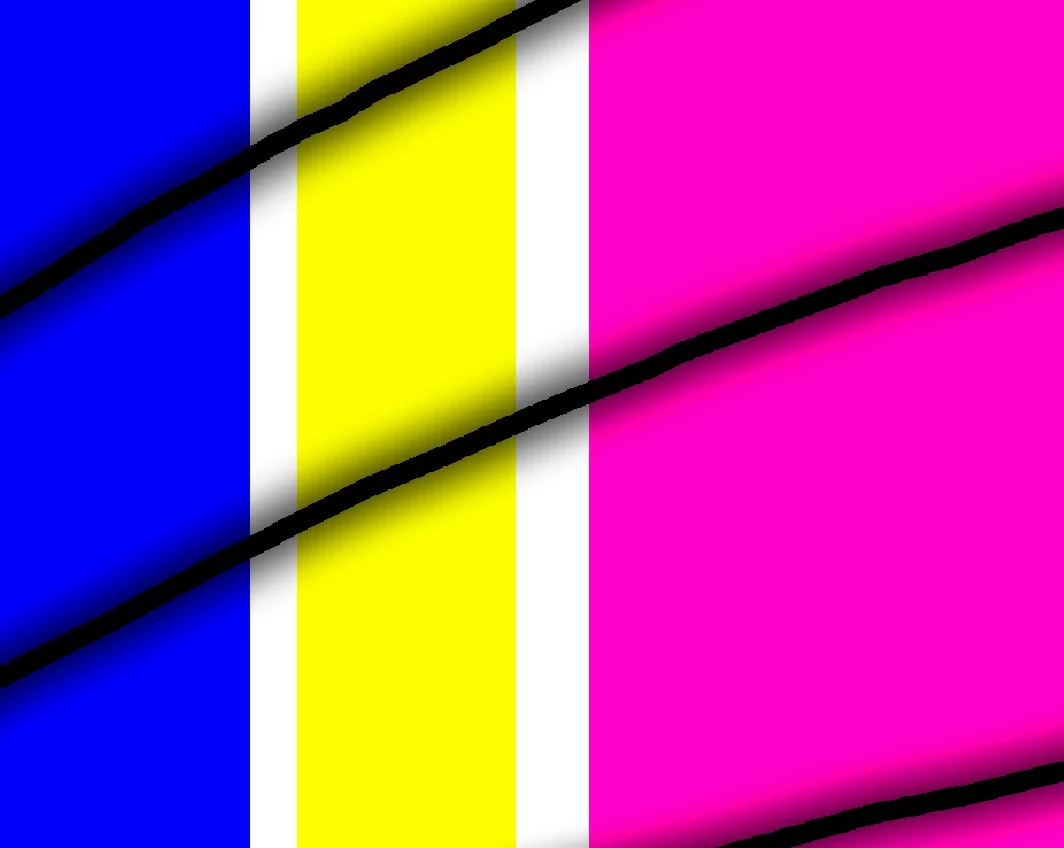

In "2.jpg," an Outer Glow is applied. Its Opacity is 100%, its spread is 0%, and its range is 50%. In my mind, this indicates the linear contour will immediately fade from 100% to 0% over the Size of the Outer Glow. In this instance, the Size is 50 pixels.

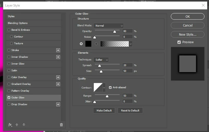

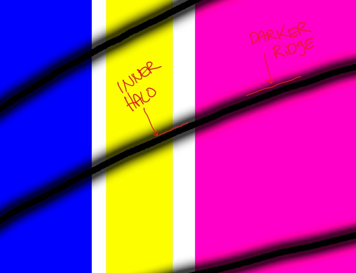

In "1.jpg," the problem occurs. At times, I not only want a glow to my line work, but I want to punch them up by increasing the Spread. I increase the Spread to 20%, but lower the overall Opacity to 80% to avoid making the line work blurry.  In my mind, this indicates the linear contour should fade from 80% ( the Opacity ) to 0% after an even Spread of 20% the Size of the Outer Glow. However, the Spread is not even. There is a darker ridge and a strange halo created before the linear contour takes control of the fade to 0%. Why?
Yesterday, I felt Spread and Range may be inversely related. Bumping Range up to 70% appears to counter a Spread of 20%. But, what happens if the Spread is greater than 50%? You can't increase Range above 100%. So mathematically, this is likely not the case. Plus, none of this solves the strange transparency of the Outer Glow before the Linear Contour takes control at 20% Spread.

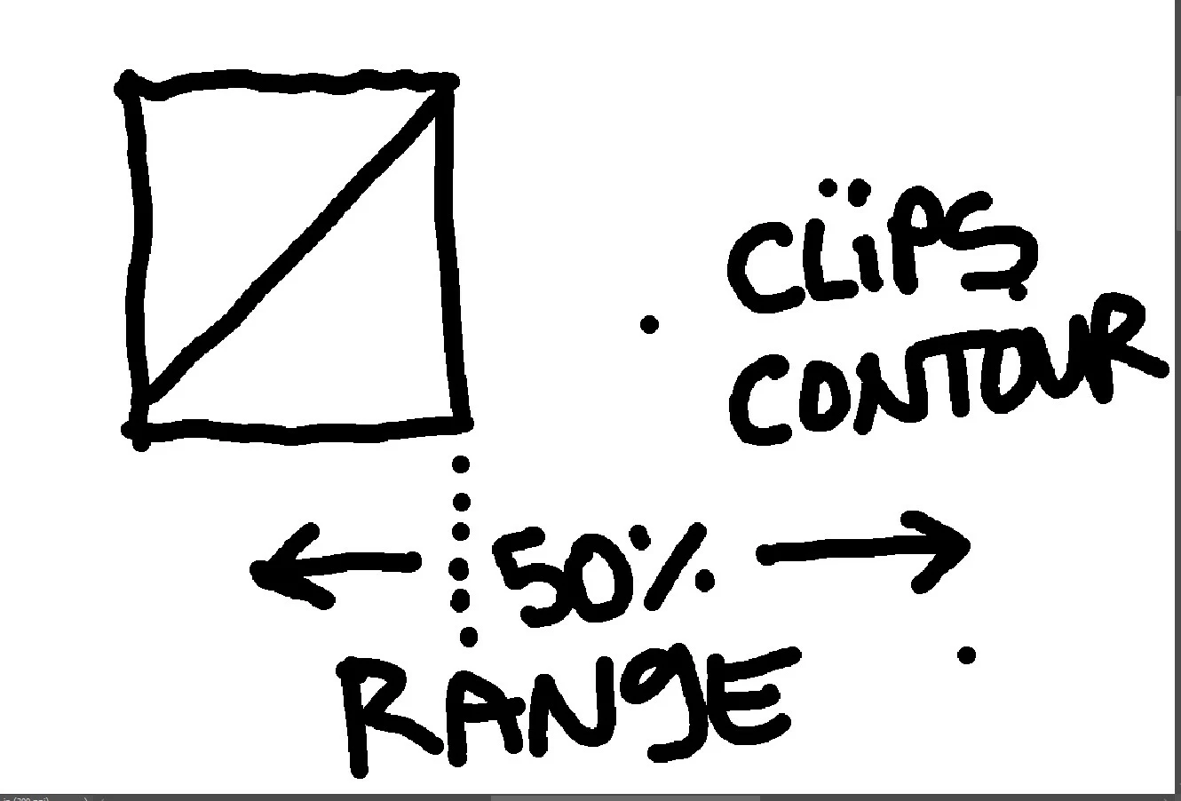

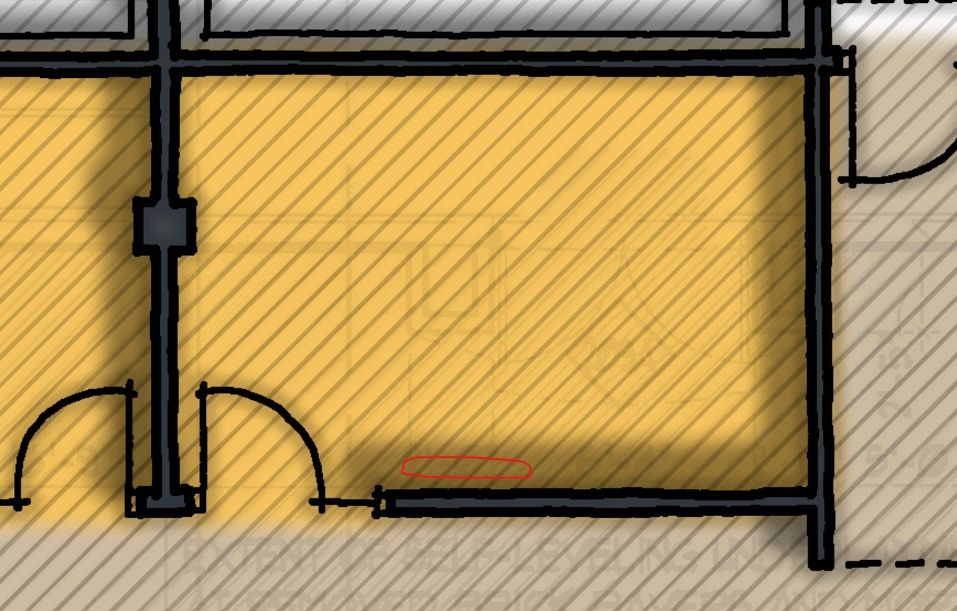

Oh! I almost forgot. "Drop Shadow.jpg" depicts a real example, but in this instance, I am using Drop Shadow and the resulting haze is circled. And, "Range Graphic.jpg" depicts my understanding of Range.
