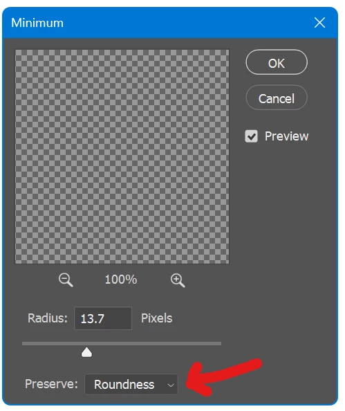

3. On the pseudo stroke layer, apply the "minimum" effect (which expands the edges) in "roundness" mode (which will make the expansion smoother than stroke would). Just set the size of it to however big you would the stroke.
The "Preserve Roundness" option in the Minimum effect is the key:

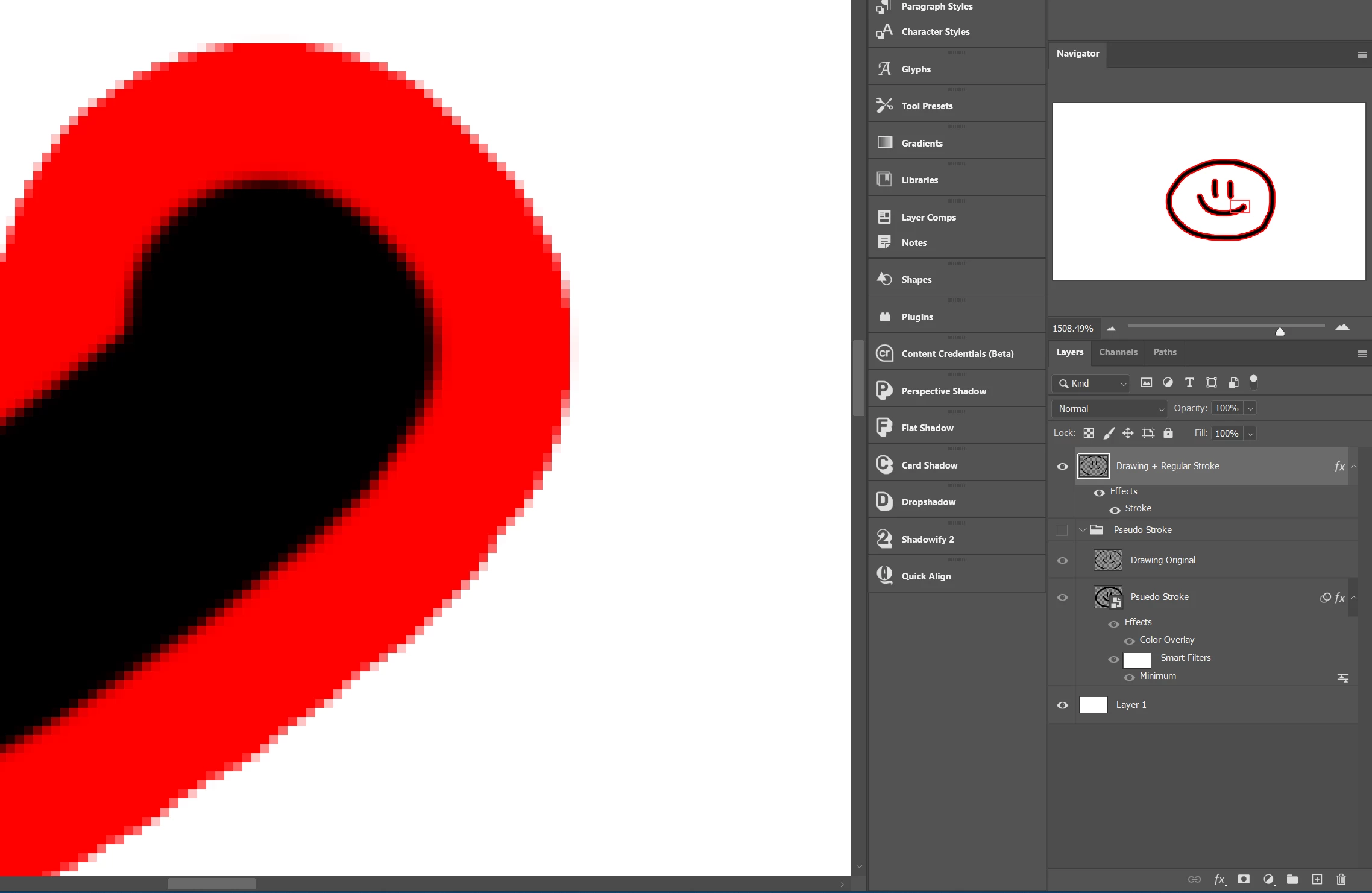

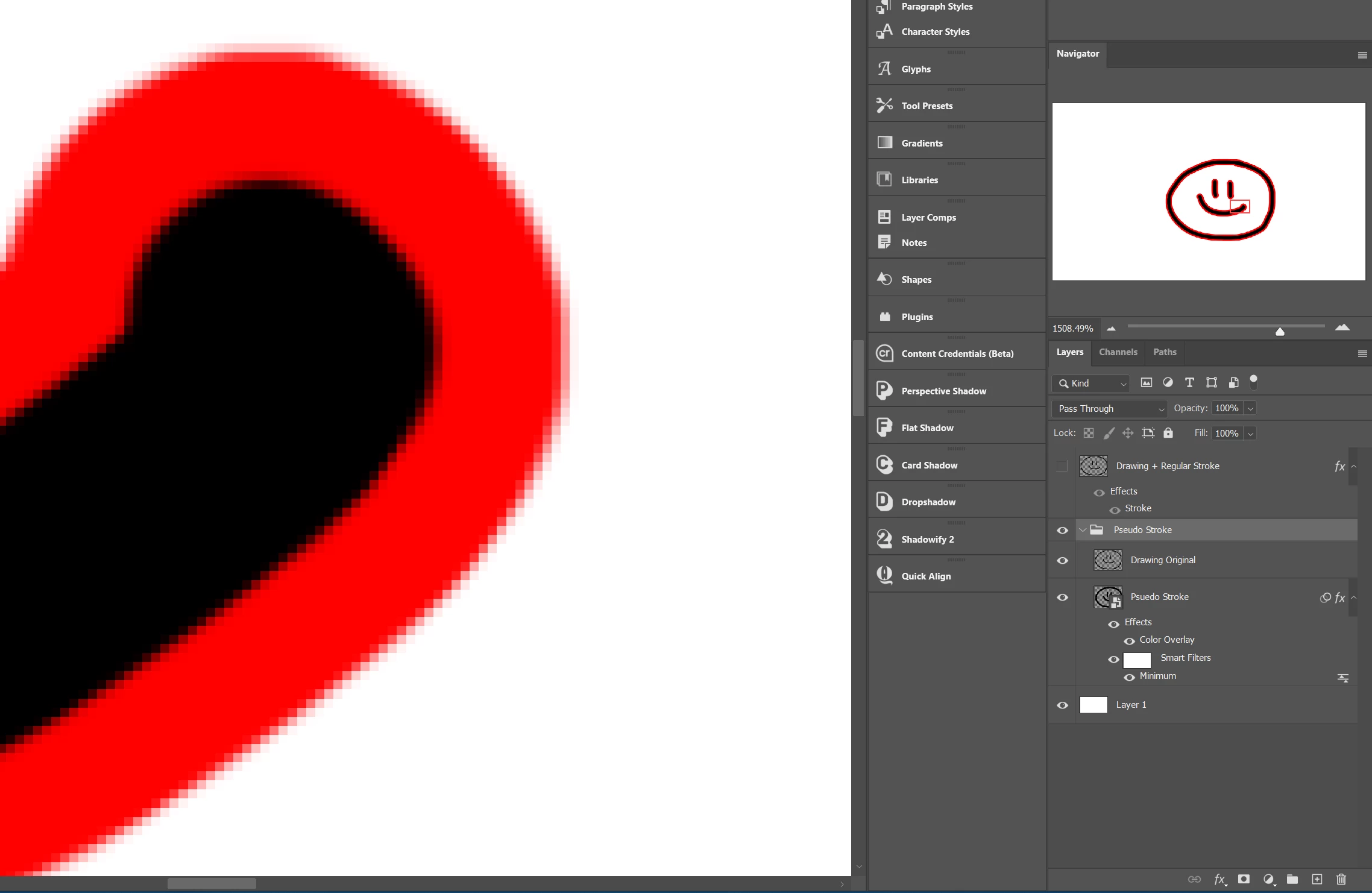

It should hopefully look smoother than the regular stroke. Here's an example test I did on a simple drawing. It's more obvious when zoomed in more.

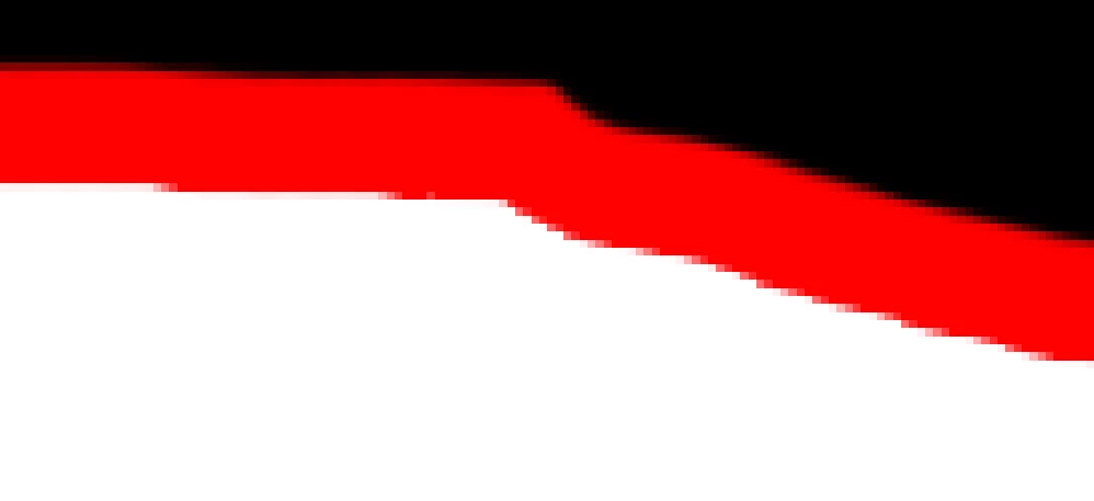

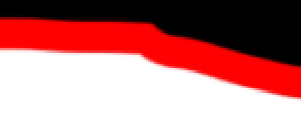

Regular Stroke:
With Pseudo-Stroke (Minimum effect + color overlay):
The difference is subtle but definitely less blocky on corners and stuff.
