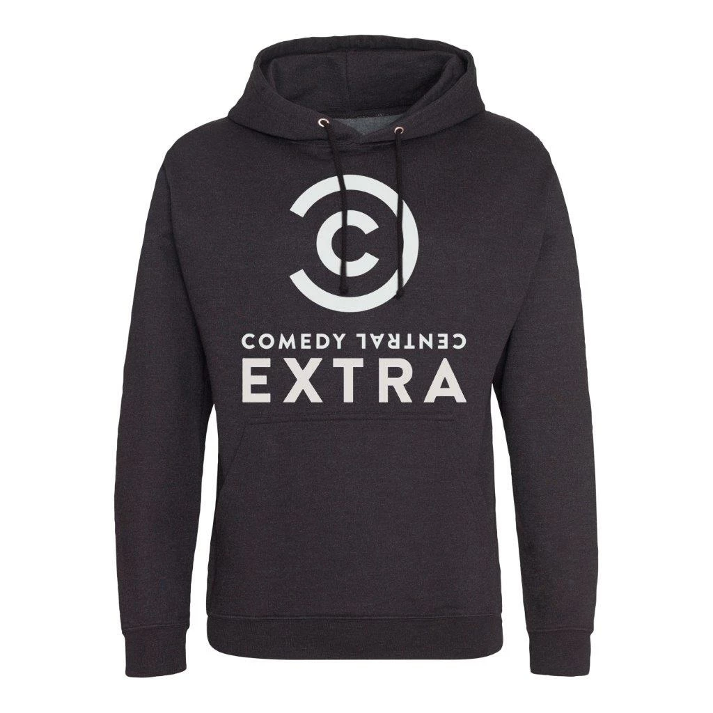

I'm trying to overlay graphic designs onto hoodies and whilst I can do it I'm really struggling to get clean lines between the draw strings and the logo.
My Process: I'm dragging the hoodie into Photoshop and then the logo and resizing / positioning before placing it and creating a layer mask and have tried using both the brush and the erasure tool adjusting the size as needed.
I've attached my finished attempt which as you'll see is fairly messy where I've tried to bring the drawstrings back on top.
is there any other method I can use or any way of "isloating" the draw strings.

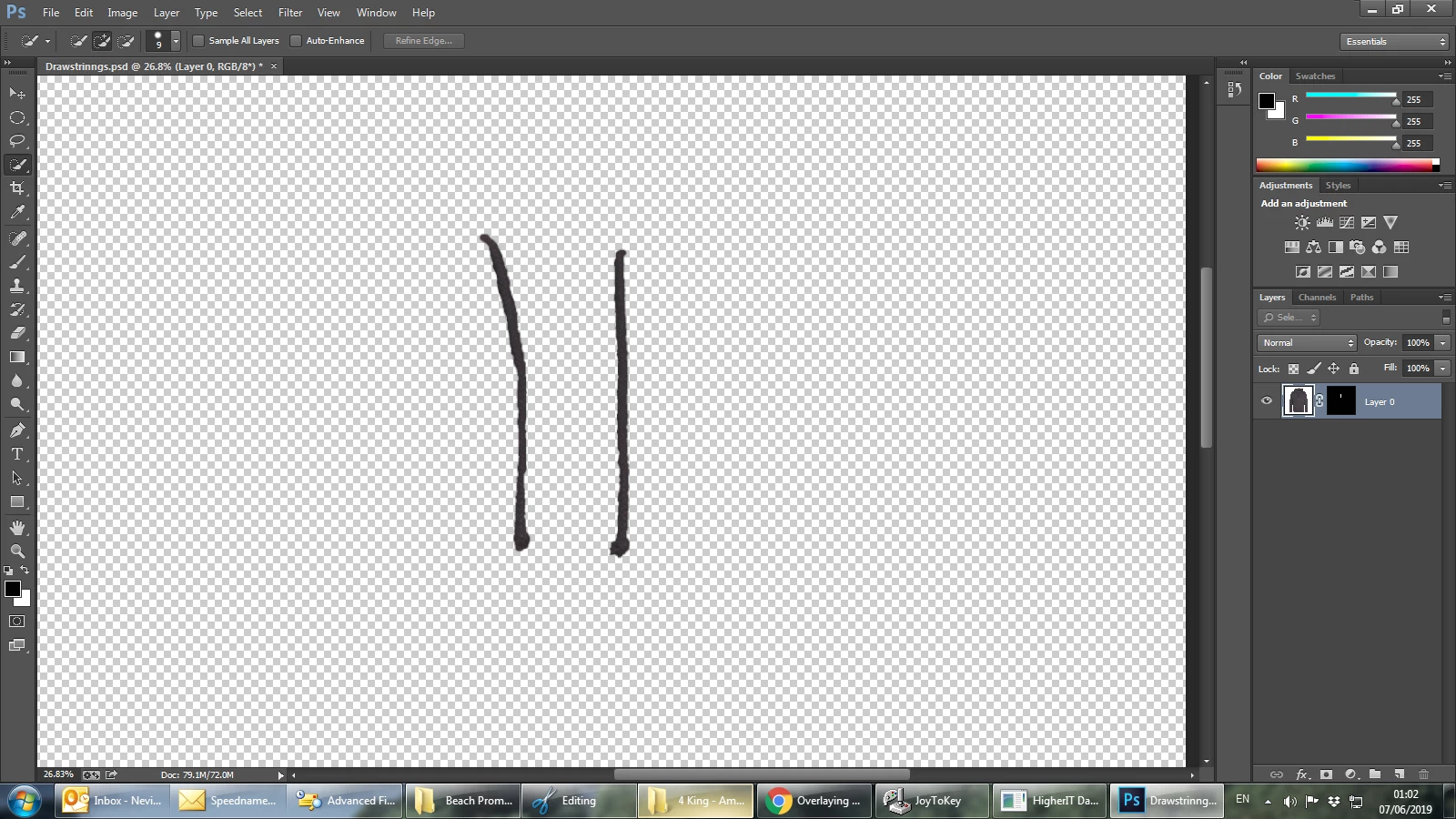

    God help me ... but I really don't get photoshop at all and I'm not a stupid person ....I don't think
    So I used the "Quick Selection Tool" ... which took me absolutely ages to trace round it properly (could be renamed the slow selection tool)
    I'm now left with the screenshot below .. the left box (the hoodie) is disabled and in essence I don't seem to be able to do anything with the program at all.
    If anyone can teach me what to actually do with a quick and effective way to do it I'd happily pay "a reasonable" fee for them showing / talking me through how to do it ... especially if there was a way I could set up a template so I could do it easily in the future.

    @Ged Traynor​  I had a quick look at using the pen tool .... can I do both of the strings at the same time do you know ... I couldn't seem to "stop it" so I could jump from one to the other as it drew a line between the two or do I have to create a layer for each and then merge them??

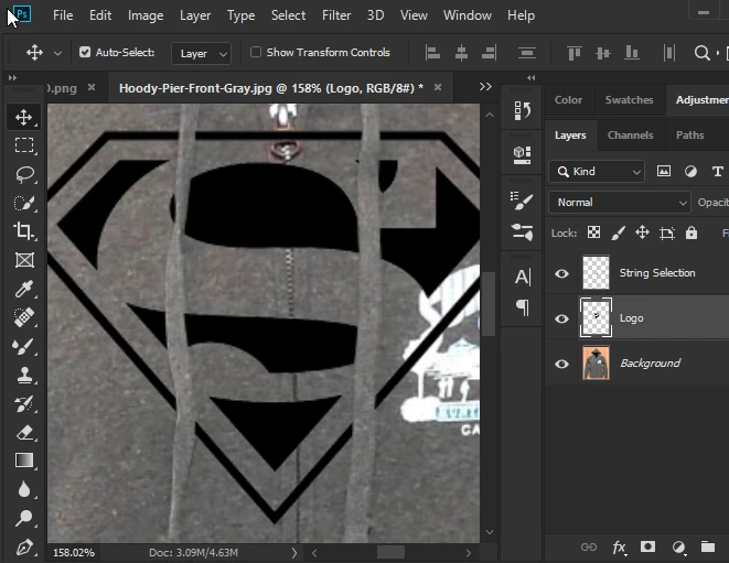

    Hi
    You could also make a selection with the Pen Tool of each string, copy them to their own layers then merge the layers, place the logo below the string layer

    June 6, 2019
    I would recommend waking a proper Selection, applying it as a Layer Mask to a Group and placing the varying content in the Group.
