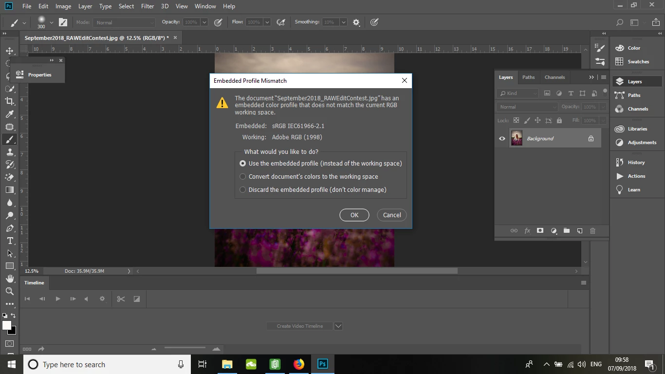

    So I have tried a few experiments now.
    Test 1) Open exported jpg saved to computer.
    I have used default option here and the image looks the same as when I first opened, edited, and saved. (Note: converting to working space presents same image - I see no difference).
    Test 2) Download image from facebook (on windows)
    Again I checked use the embedded profile. The image looks good, same as when first saved in Photoshop

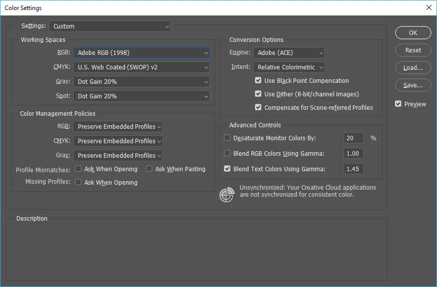

    One the web your images should be converted from adobe rgb to srgb that is good policy.  However,  If you convert mismatch color image to Adobe RGB that is fine. If by default you preserve image color space you should not assign AdobeRGB to the image.  For the the color values in the image may be sRGB and assigning Adobe is not a correct thing to do.  If you the export save for web and convert to srgb you may mess up the colors a second time.  You should only use  Assign Profile: Adobe RGB if ton know the current value are Adobe RGB color values and the source file did not have a color profile embedded in the file.
    What do your Photoshop Color settings look like? If the look like this I do not think you should use assign Profile Adobe rgb.
