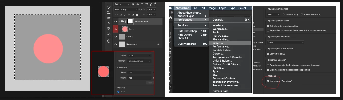

I noticed in new version of Photoshop the Export As... function no longer uses the mask but instead crops to contents.
For example if you make a group with a 512x512 mask, place an image inside it with some space around it, Export As does not export the 512x512 masked are but instead crops to the content image.
I don't see how this is useful change as if you've masked the group and wanted to export only its contents you would just export the layer with contents, not the masked group.
There is a workaround though, you can switch back to Legacy Eport settings in preferences, but then again everyone who uses the psd has to do the same to get it working properly.
Does anyone know another workaround for this that would not require switching to Legacy settings?
I can see this change causing issues to a lot of users and frankly can't see the benefits to this change.
PECourtejoie
PECourtejoieCorrect answer
Mar 23, 2022 4:10 PM UTC
HEllo, I think this function exists only in the legacy export as function that you activate with the menu Edit Photoshop/Preferences/Export

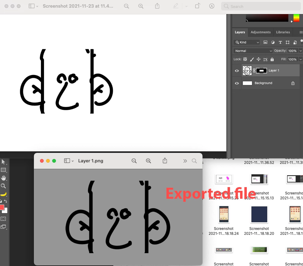

radmirsharipov
Nov 23, 2021 9:19 AM UTC
Hey
I don't remember exactly when it happened. But there is a feeling that after I connected the Wacom Cintiq to the laptop. (I used it for a week, I'm not sure if it could somehow affect photoshop)
There is no errors. Color settings in attachment.
I've been resetting and reinstalling photoshop already.
Photoshop version 23.0.1
macOs Big Sur 11.5.1
Macbook Air M1 (2020)
I think I found a pattern.
If mask crosses over layer content png exports as it should but if layer content is inside mask area and not touching mask borders then layer exports just cropped in his original form.
I hope I am clear and the problem is understandable. Since I am not a native english speaker.

Aug 24, 2021 11:43 PM UTC
The new Export As will ignore all fully transparent pixels. Using a mask to add "white space" around an object wouldn't work in this context. The best way to approach what you are trying to accomplish is to use the Cavas Size settings within the Export As dialog. In your screen shot, the current settings are 165x165, the size of the circle. You can simply set this to 512x512 and you would get the desired effect.
jpt7765Author
Aug 26, 2021 8:48 AM UTC
Thank you! That is a good point and good to know.
Unfortunately editing canvas in that dialog adds space equally around the content image, so it is unusable as it is then uncontrollable how the content is placed inside the image space. If any changes were made to content shape that would edit the whole position when exported (would break for example icons and such).
Also point is to have the size determined in the group mask so anyone using the PSD can just export the image correctly without further tweaking of numeral values.

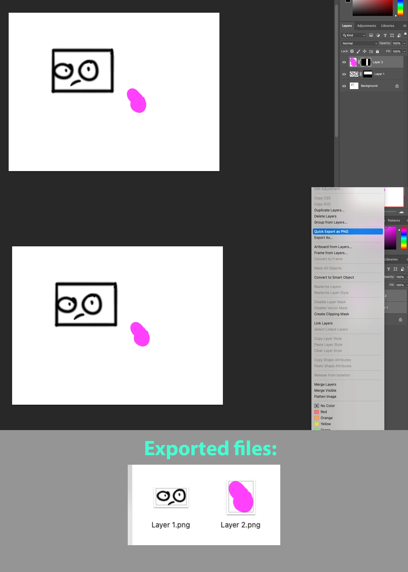

Aug 24, 2021 11:09 AM UTC
Preview image explaining the issue
