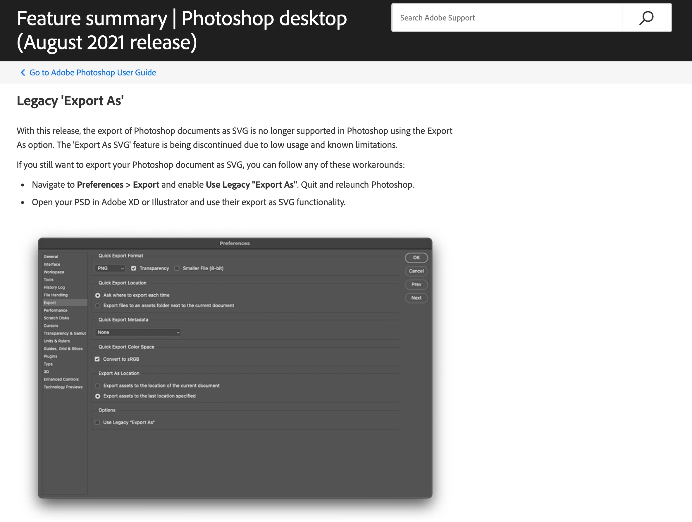

I noticed in new version of Photoshop the Export As... function no longer uses the mask but instead crops to contents.
For example if you make a group with a 512x512 mask, place an image inside it with some space around it, Export As does not export the 512x512 masked are but instead crops to the content image.
I don't see how this is useful change as if you've masked the group and wanted to export only its contents you would just export the layer with contents, not the masked group.
There is a workaround though, you can switch back to Legacy Eport settings in preferences, but then again everyone who uses the psd has to do the same to get it working properly.
Does anyone know another workaround for this that would not require switching to Legacy settings?
I can see this change causing issues to a lot of users and frankly can't see the benefits to this change.
Correct answer PECourtejoie
HEllo, I think this function exists only in the legacy export as function that you activate with the menu Edit Photoshop/Preferences/Export

The new Export As will ignore all fully transparent pixels. Using a mask to add "white space" around an object wouldn't work in this context. The best way to approach what you are trying to accomplish is to use the Cavas Size settings within the Export As dialog. In your screen shot, the current settings are 165x165, the size of the circle. You can simply set this to 512x512 and you would get the desired effect.
September 21, 2021
Hi!
Where exactly in the summay of update is noted it's going to have an impact on the export of transparent space on a layer/group? It only mentions the SVG export not being supported anymore.
We lost hours of workarounds instead of using a simple and super fast command...
Thank you!
