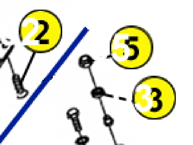

I've got PSD documents with various objects on it (text, images ...) and some of those images represent numbers (see the Yellow dots).
My challenge is to transform those dots (images) onto a text box, at the exact same place and filed with the name of the object (each object is named "01", "02" ...).
My guess is to use the coordinates of each dot's layer, save them as variables, paste a text boxfrom another document on the page and then assign the saved coordinates to this new text box. I've no clue for pasting the object name into this text box though ...

Well, Chucj, thanks to your help, I managed to write a correct script that actually go trought my Layer Set and attribute the good name to the text box
My last problem is the misalignement with the original Dot. Any idea?

I'm not sure why you're getting the offset, unless there is something more in the dot layers than just the dot circle. Can you post a screen shot of just one of the dot layers? Do a ctrl/cmd-T on the layer to show a transform box around the layer so we can see exactly how big the layer is.
