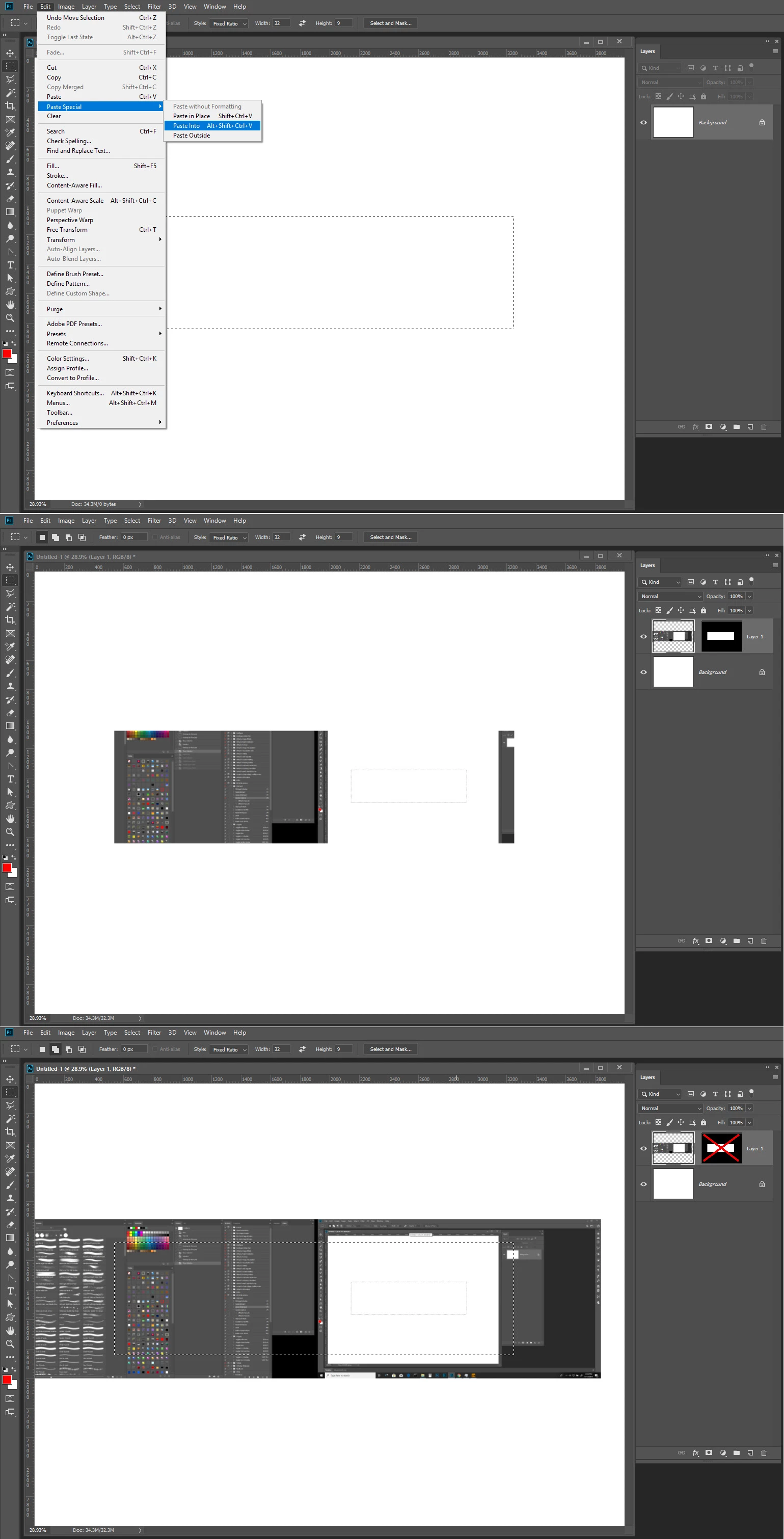

    The sounds like normal operation. For "Paste INTO"  (Alt+Shift+Ctrl+V) The marching ant will also be deselected when you use "Paste in Place"  (Shift+Ctrl+V). However, Past Into will paste all the pixels in the clipboard into the new Photoshop layer where Past in place may not.
    I do not use AI.  However I do use Photoshop. When you have an Active selection and use Paste Into the marching ants will be deselected.  However, the selection should still be in effect because an unlinked layer mask containing the selection was added to the new layer in  Photoshop which will confine what what is visible in the new layer to the selection area used when you used place into.
    I use Place Into all the time to tile images onto a canvas and confine what is visible to the place into area.  I resize the image first to fill the selection the layer mask mask off any excess image when the image and selection have different aspect ratio.  The image will be wider or taller then the selection area.
    Here I simply use PrtScn to copy my displays to the clipboard then use paste into. You should see the selection was deselected the layer mask was added and it confines what is visible to the selection area.

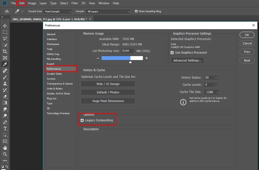

    This has worked for me for years and just stopped working today. Maybe I will try a restart of my computer. I tried selecting the "legacy compositing" box as suggested by Muqqarib above, but it didn't work.

    Can you please try to select this legacy composting option and restart and see if its work if you are using Photoshop Cc 2019.
    Bronte222Author
    November 13, 2018
    I just tried it, quit and reopened Photoshop and it still didn't work. Do I have to restart my computer?
