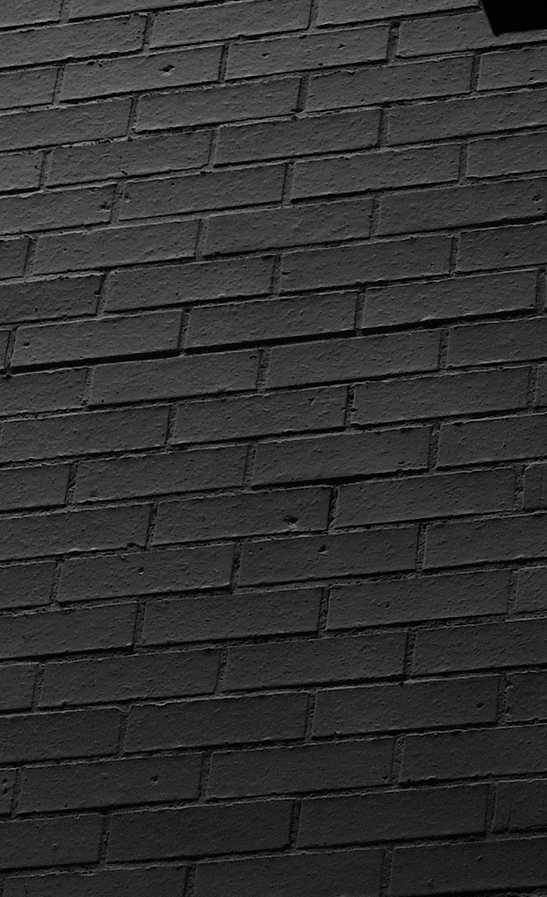

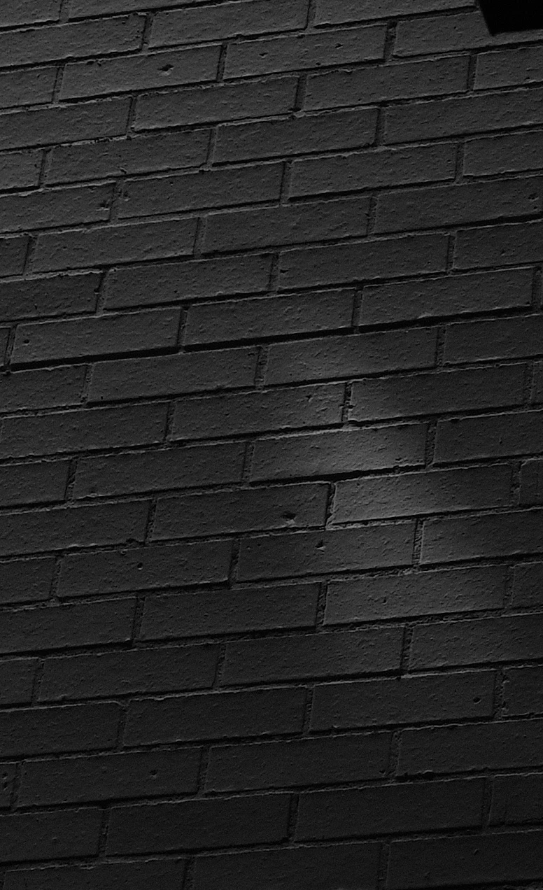

What is the best Photoshop method for eliminating the light patch in this photo?
I cannot clone as the brick pattern is not uniform. The light patch is very irregular in shape and the edges are not well defined.

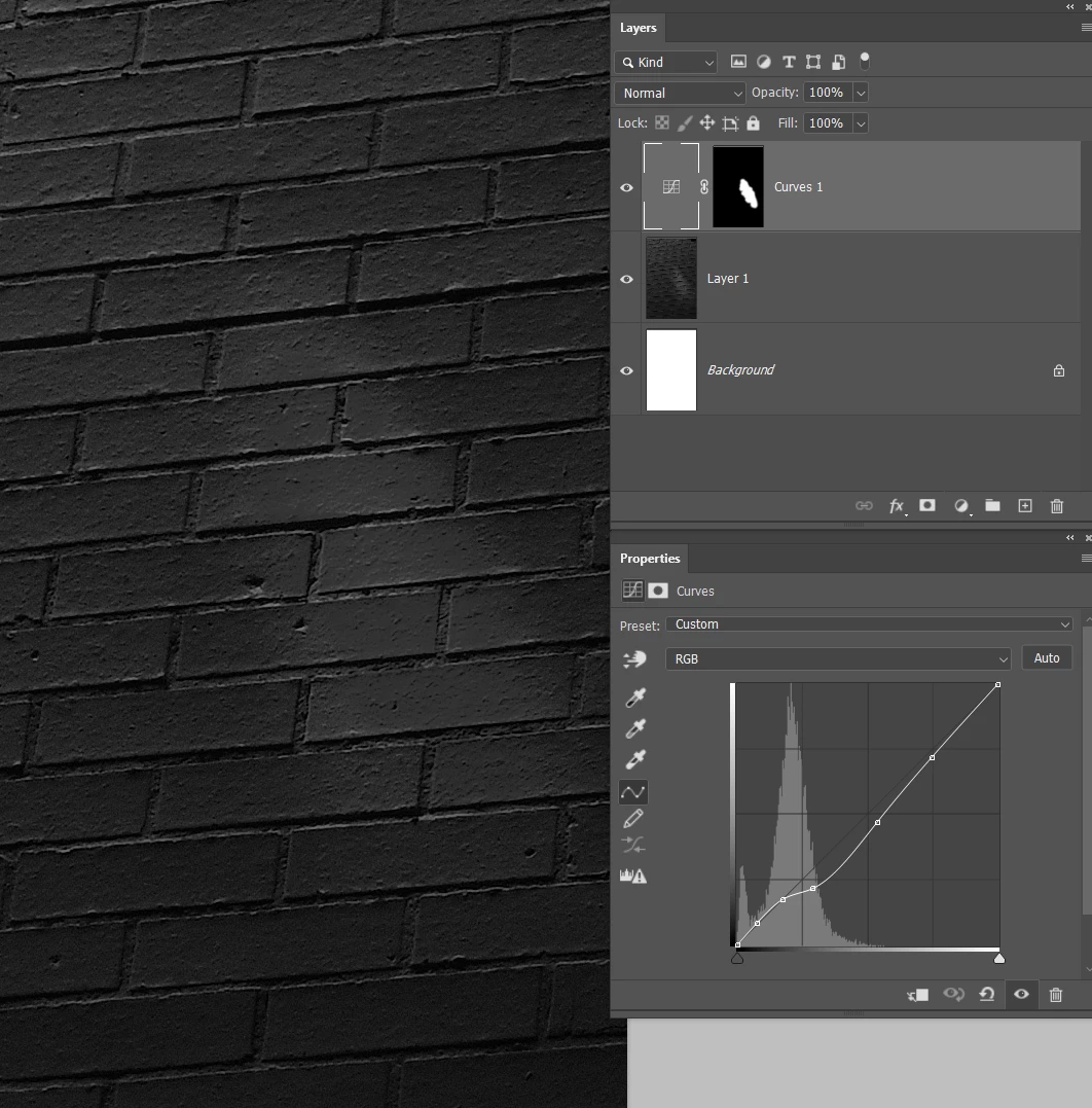

I did it by using a "burn" technique that uses Curves and Saturation, applied with a soft brush at 1% flow to gradually apply the effect without leaving brush strokes. (I had to first convert the image from Grayscale to RGB).
There are many variations of this technique, including the built-in Burn tool in Photoshop, you may have to play around with them to find the one you are comfortable with.

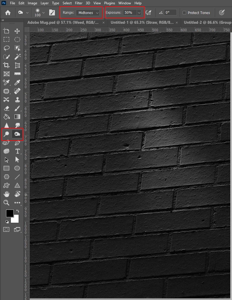

The Dodge and Burn tools have the advantage of being able to affect specific tonal ranges. So using the burn tool set to Midtones in the Options bar with a soft brush set to 50% or lower, will let you build the effect.

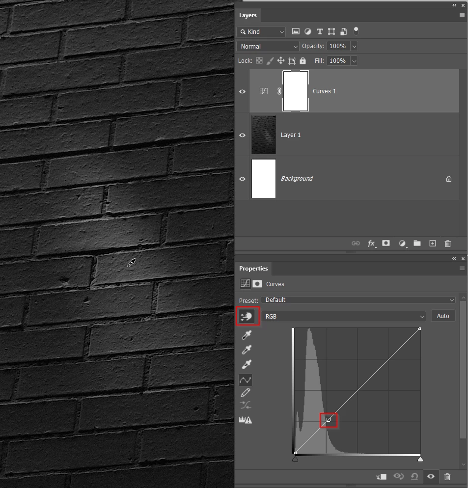

A Curves Adjustment layer also lets you work on just the tonal range required.  If you create a curves layer and click on the little hand icon in the top left corner of the Properties panel, and hover the cursor over the area you want to affect, you will see a point on the curve for that tonal range.  If you left click, a point will be placed there.
You need to place more points on the curve above and below to lock those values and adjust the curve for best effect.  This will still affect the entire image, so invert the curves layer mask, and paint thew area back in with a soft white brush.

Trevor, I'm so appreciative of the trouble you've gone to.  It seems really expert advice.  And the graphics you've included are so useful.  I'm a relative beginner with Photoshop and you've given me what I was looking for.  What I put in my original query was just a crop. The full image is definitely pretty good, just spoilt by that light patch of reflected sunlight.  I'm going to work through as you've suggested.  Cheers, Lloyd

I would probably use a soft-edged selection and Curves.
