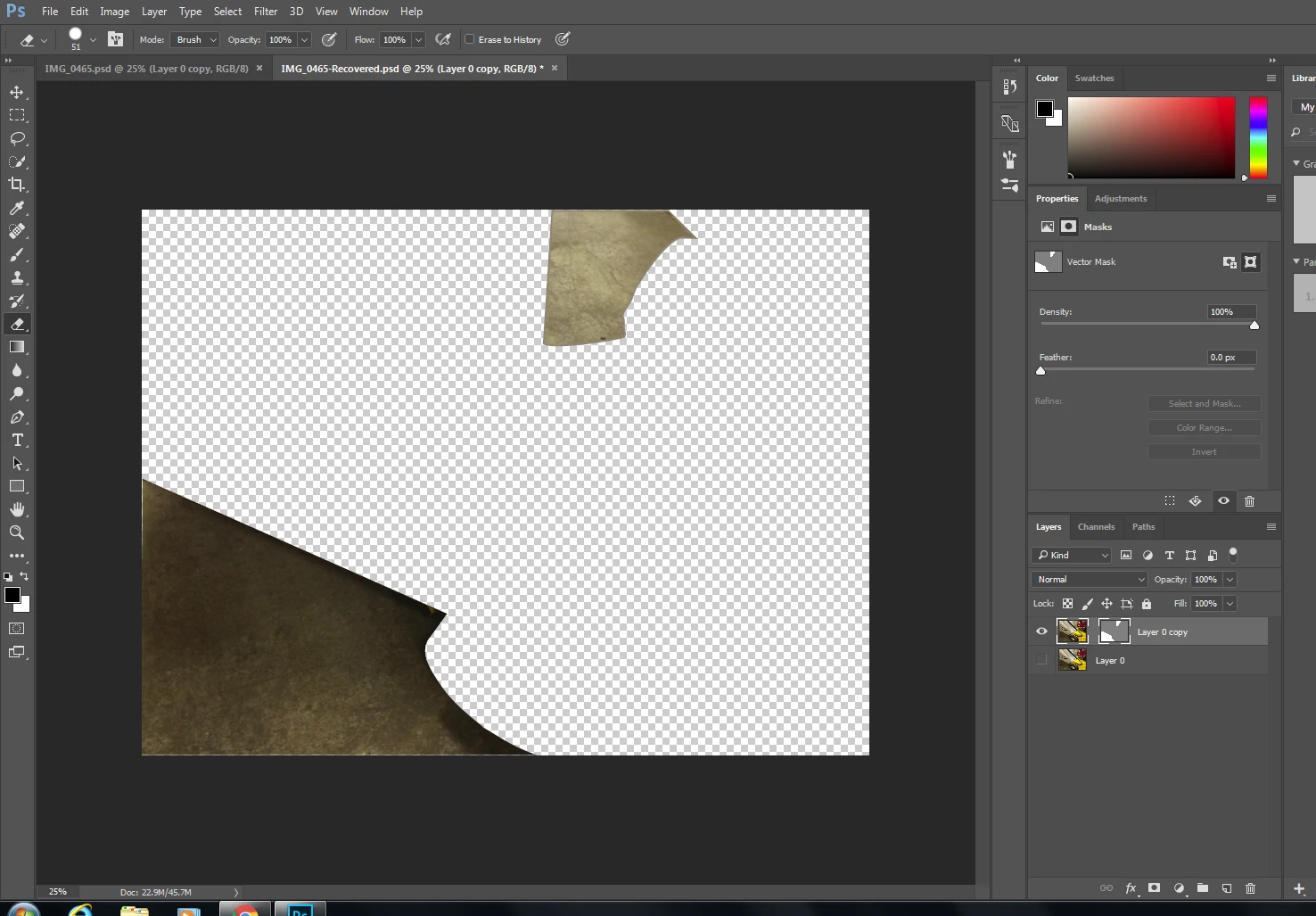

    Here's what I get after I apply the mask.  It's the inverse of what I want.

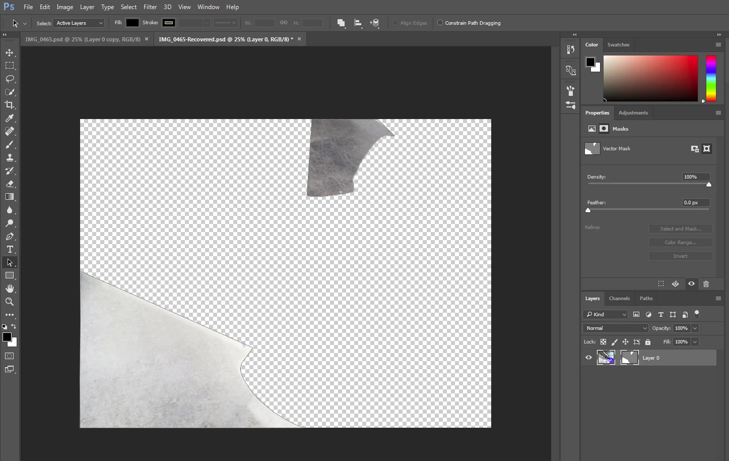

    After selecting the mask and hitting Ctrl-I, I get this:
    I now see that my mask is a 'vector mask' instead of a 'layer mask'.  How can I make it a layer mask?

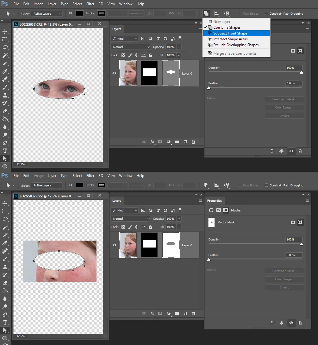

    When a path is selected using the path selection tool you can use the + & - keys quicklyley switch between Combine(+) and subtract(-). This is what you might use instead of CMD+I, as someone else mentioned this is an adgustment not a state change when using the pen tool.

    The layer mask you created is it a vector layer mask or a raster layer mask? in Either Case it can be inverted one way or and other. How you invert a layer mask depends on the type of layer mask it is. A raster layer mask is  done via invert whar a vector mask you need to change the closed path type  add, suntract, exclude, or intersect.  You need to use the path selection tool to select the path the use the tool option bart to change the path type.

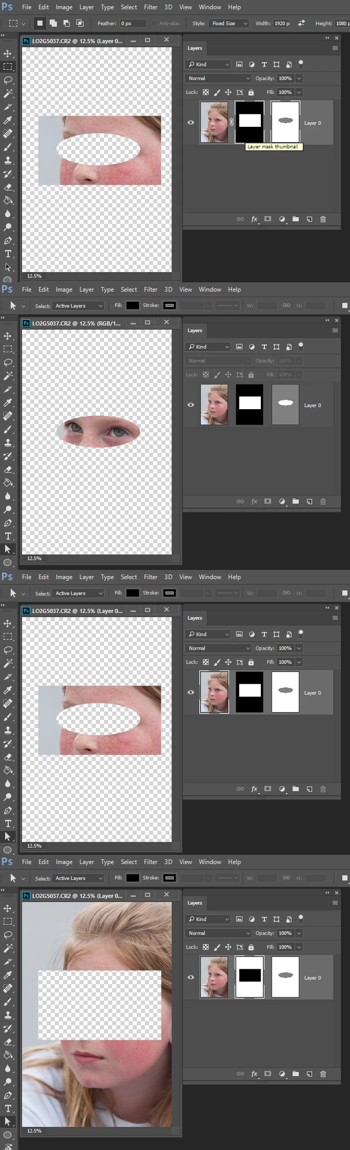

    Is it possible that, in the Layers panel, the image rather than the mask has a double frame around it indicating you want the change in the image and not the mask?
    Click on the mask in that layer, then invert
