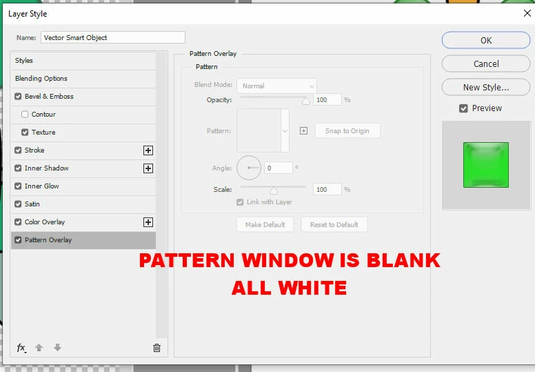

Well as usual, after another update, there are problems.   Had to fix my curser back like I had it and I see even more things to re-set.
But the worse thing is my Patterns.  I have lots of patterns  and when I try to open them the whole window is whited out!  No way to load more or anything.  Just a totally useles window with nothing clickable.
Please tell me what has happened.  Yes, I will send a screenshot if you need it.

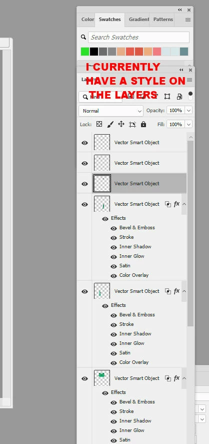

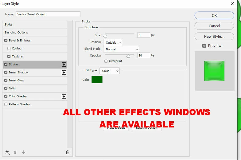

pslane1Author
August 1, 2024
I am adding patterns to layers as I go along.  I gave up adding a pattern and just added a style. But Patterns won't work on any layer.  Screenshot shows my layers with the styles on.  No 2 shows pattern window whited out and un-usable.  No 3 shows a normal window for adding strokes.
I use the current version of Photoshop and just updated when this happened.   There is no access to pattterns.
