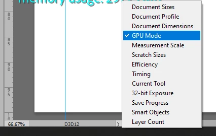

Indeed, when the pen tool stops working, the graphics will be in CPU mode. When it's working, it will say D3D12.

It may be that the pen tool works after resetting your preferences because you return to using the GPU.  It would be helpful to know if you are dropping out of GPU mode when the pen tool stops working.
Please reset your prefs and change the document setting to “GPU Mode.” When the GPU is working, it should say, “D3D12.”  When the pen tool stop sworking, does the GPU mode change to “CPU?”

It’s possible that you are dropping out of GPU mode, and into CPU mode, while working.  The pen tool should still work in CPU mode, but the overall experience is better in GPU mode.
First, verify if the pen tool is working correctly while you are in GPU mode
You can track which mode your document is in by changing the field at the bottom of the document window to “GPU Mode.”
