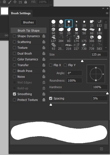

I have used the pen tool in Photoshop daily for years and have always been satisfied with it.
Today, unfortunately, the pen tool is not following my brush setting. In this example, I have my brish set at 3 pixels (I am forcing the issues) and when I used the pen, either with simulated pressure or not, it did not conform. Here's an example:

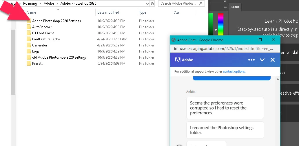

Karen_Little
October 10, 2020
SOLVED - With some help from the Adobe Facebook team, we determined that my problem was not common.
An Adobe Technician mounted my computer and determined that my set up file was corrupt, and reiniated it.
The only thing that I could think of that might have affected it is that I have a lot of trouble with Illustrator crashing, and I was working with both programs the night before the problem. Hopefully, I'll get that solved next week.

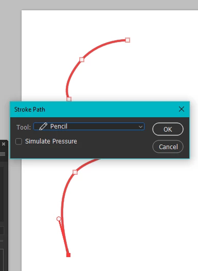

HUGE CHANGE HUGE CHANGE ---
The pen tool appears to no longer be connected to the brush tip.
I changed the STROKE to pencil and it the line came out correctly.
This is really awful in that Adobe did something that changed settings - I do not know how much trouble I'm going to have from this point forward. I am going to work with the pencil setting for stroking now .... but I am betting that strokingwon't work with special brush tips. BIG PROBLEM.

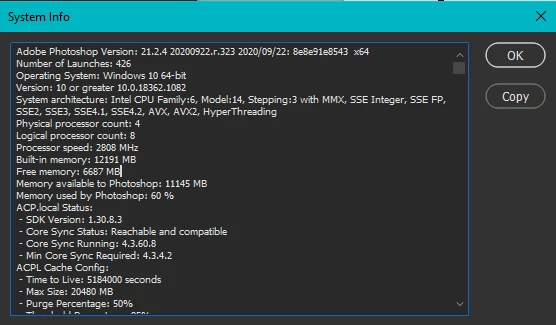

Karen_Little
October 8, 2020
There are 2 updates, 20.0.10 (which is currently updating, and 21.2.4, which I'll update when finish.
I am praying it solves my problem . . . until it is solved, I'm dead in the water

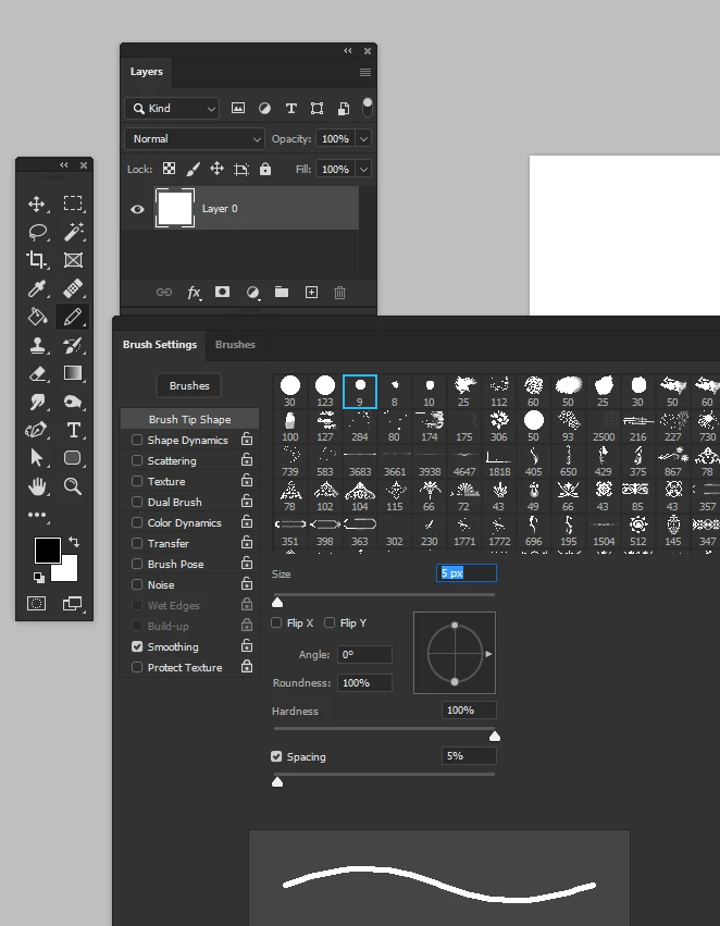

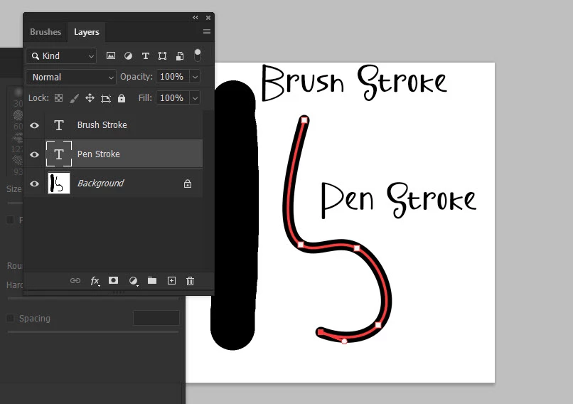

Karen_Little
October 8, 2020

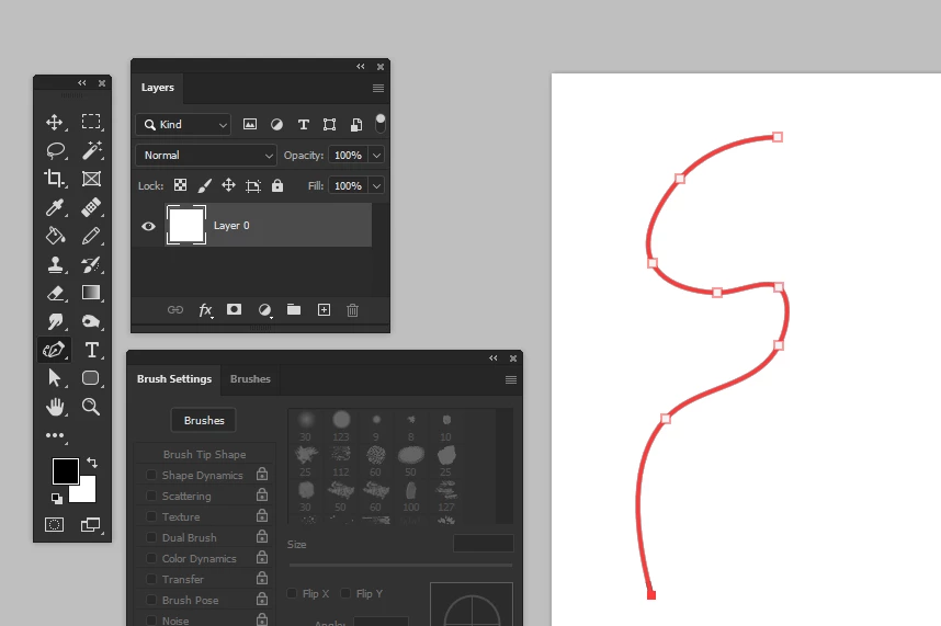

I am in the process of getting screen samples - I rebooted my computer. Same problem. The pen line is always the same no matter what I set the brush at. I am thinking of reinstalling photoshop.
3 screen captures - pen setting, brush setting, and brush and pen usage

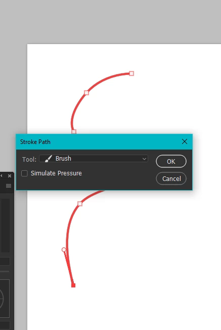

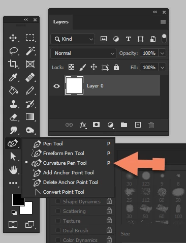

c.pfaffenbichler
October 9, 2020
What are you talking about?
Please don’t clip the screenshots to exclude relevant parts – one canno teven see which tool actually is selected when you hit »Stroke path …«.
What are the exact settings when you alt-click the »Stroke path …«-button?

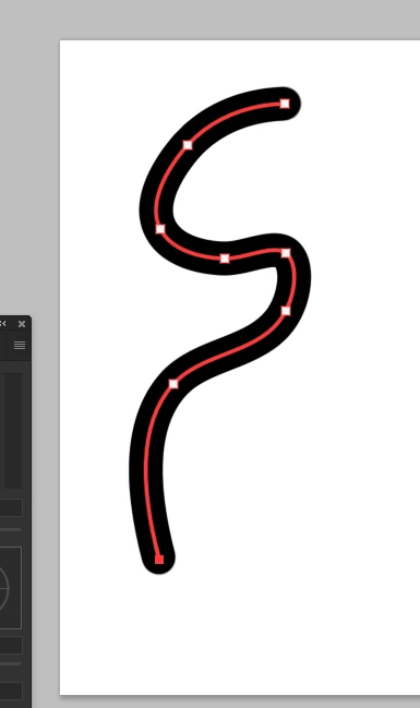

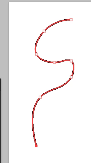

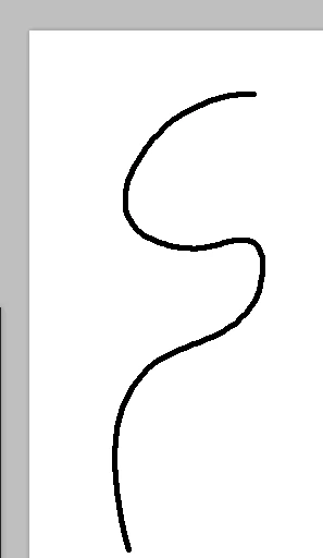

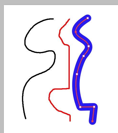

Karen_Little
October 9, 2020
1 - set up brush stroke. It is 5 px, hard round.
2 - select pen tool
3 - Draw path
4 - Prepare to stroke path with 5 px width
5 - path drawn using pen and brush point

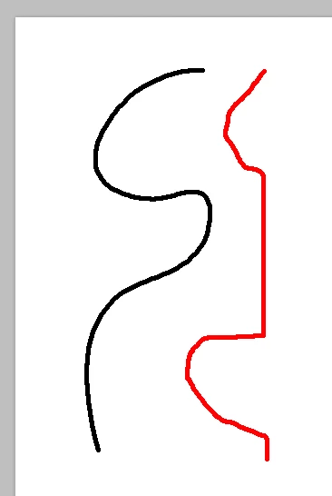

6 - this is not a 5 px path. Using this same path, here is the pencil version of it
7 - the outcome of the pencil version with the path overlay
8 - the pencil version of the path at 5 px
9 - and here, in red to show the difference, is the brush using the 5 px path
10 - and to be clear, in blue, here is a path drawn with the pen tool using the same brush point
Discussion: Until a day ago, one way to set the pen path width and other considerations was through the brush tip settings. I've used it daily for years and years (note that I am one of the first Photoshop for the PC users in the world today - used it since its inception).
There is a glitch in the system that is causing this not to work. Adobe needs to fix it and I am having this discussion in another place.
*NOW* if you can use the pen/brush setting together without an issue, then something is truly wrong with my computer. Realize, however, that all of my Photoshop updates have been installed, and my PC has been rebooted twice since I reported this.
This is a screen capture, but I could print out the entirety of its contents.
c.pfaffenbichler
October 8, 2020
Could you please post a screenshot with the pertinent Panels (Toolbar, Layers, Channels, Options Bar, …) visible and the Brush Tool selected?
