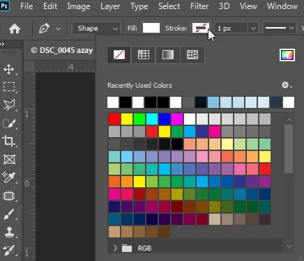

Thanks. You are a big help. but the line is in a default color. How do i get it to be the same as the color shade I am using? I have done it before but...... can't get it now. Thanks so much from Ann in the boston MA area.
barbara_a7746676
September 5, 2020
You can choose a stroke or fill color in the Options bar, and you can also change the stroke weight:
