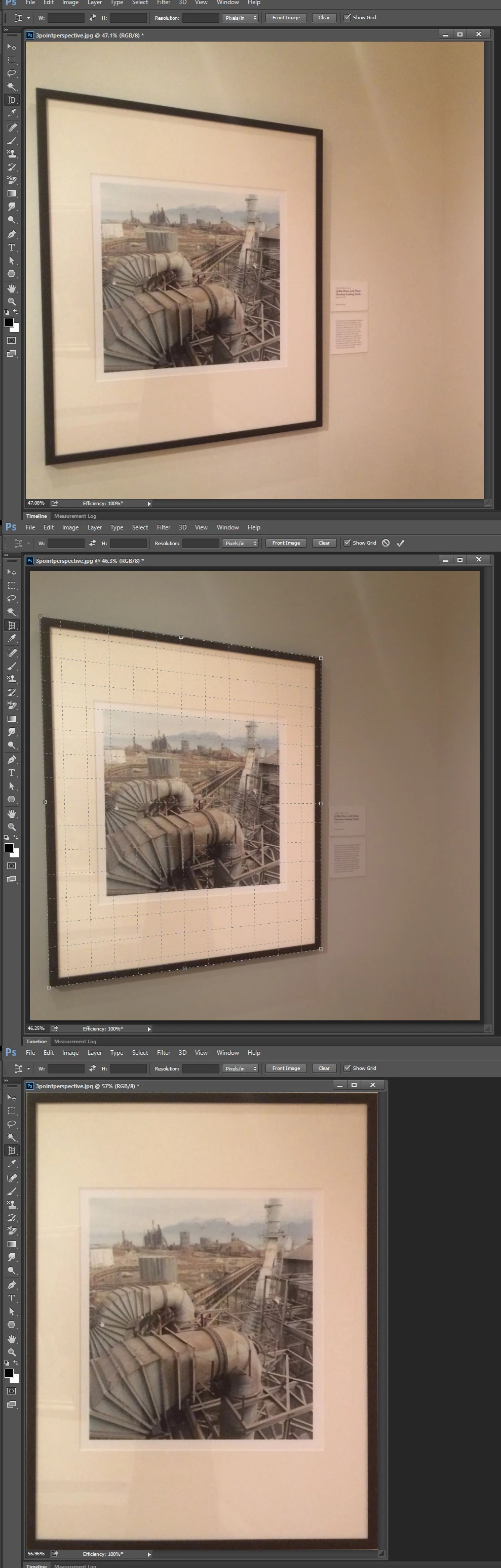

    You change the perspective of the crop to be a rectangle with 90 degree corners. I use it for squaring up a picture of a bill I take that I need to emails to someone. When I hand hold my camera it is never perfectly square and parallel with the bill on the floor or wall there is some perspective I want to remove.
    Here is an extreme example. of removing perspective.
    JJMack
