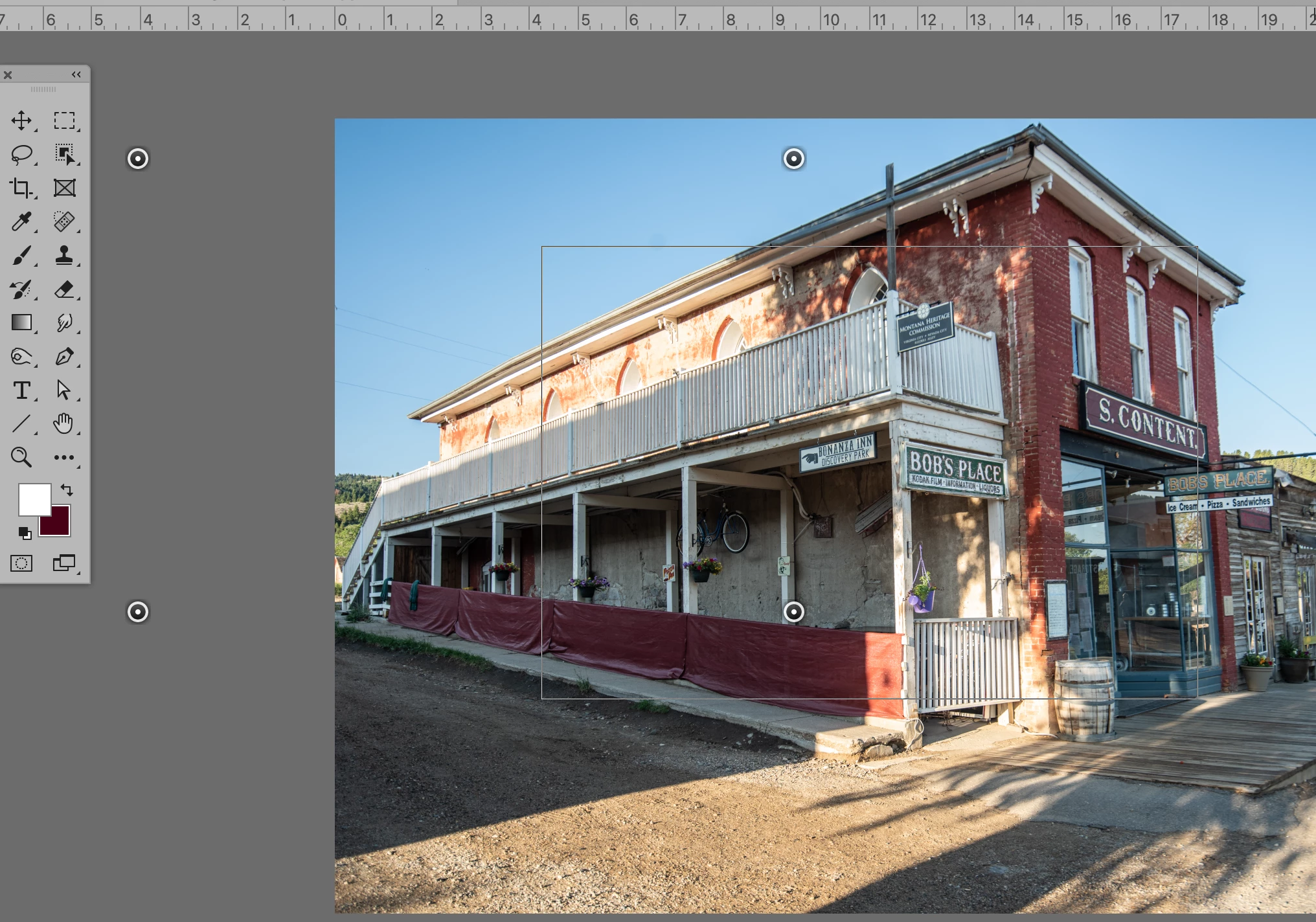

Argh! I am so frustrated with trying to use Perspective Warp in PS 2023. It is not functioning correctly on either my 2017 or 2020 macbook pro. It works fine on the Mac 1 at work. I have updated the OS, and checked the GPU compatibility but does not help at all. The grid is very weird - it is a simple square of a very fine line with no grid, and without pins. The pins appear left of the grid - floating on their own about 20% away from the box/grid. The tool sort of works - I can drag the corners around if I can see one, but it is not responding easily or predictively.
Here is a screen shot of what I see when I try to use the tool! HELP!
Correct answer J453
Try restoring your preferences using this manual method:
https://helpx.adobe.com/photoshop/using/preferences.html#Manually
If that doesn't solve it, you can quit Photoshop and put the Settings folder back

Oh THANK YOU! That worked. 🙂
