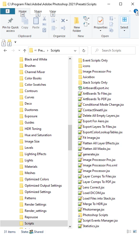

You have never used Image processor, Photomerge, merge to hdr, contact sheet II, export layer to files, load file into a stack etc. Scripts can do more than Actions. They are Programs not just a sequence of fixed action steps like Actions.
