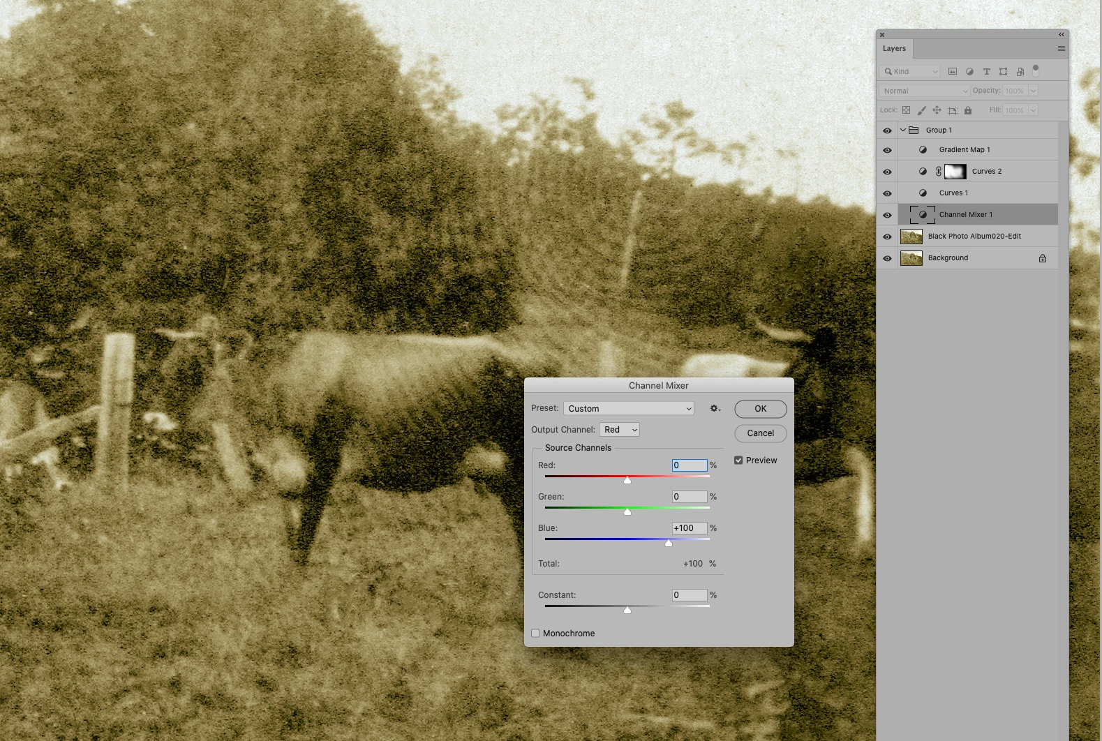

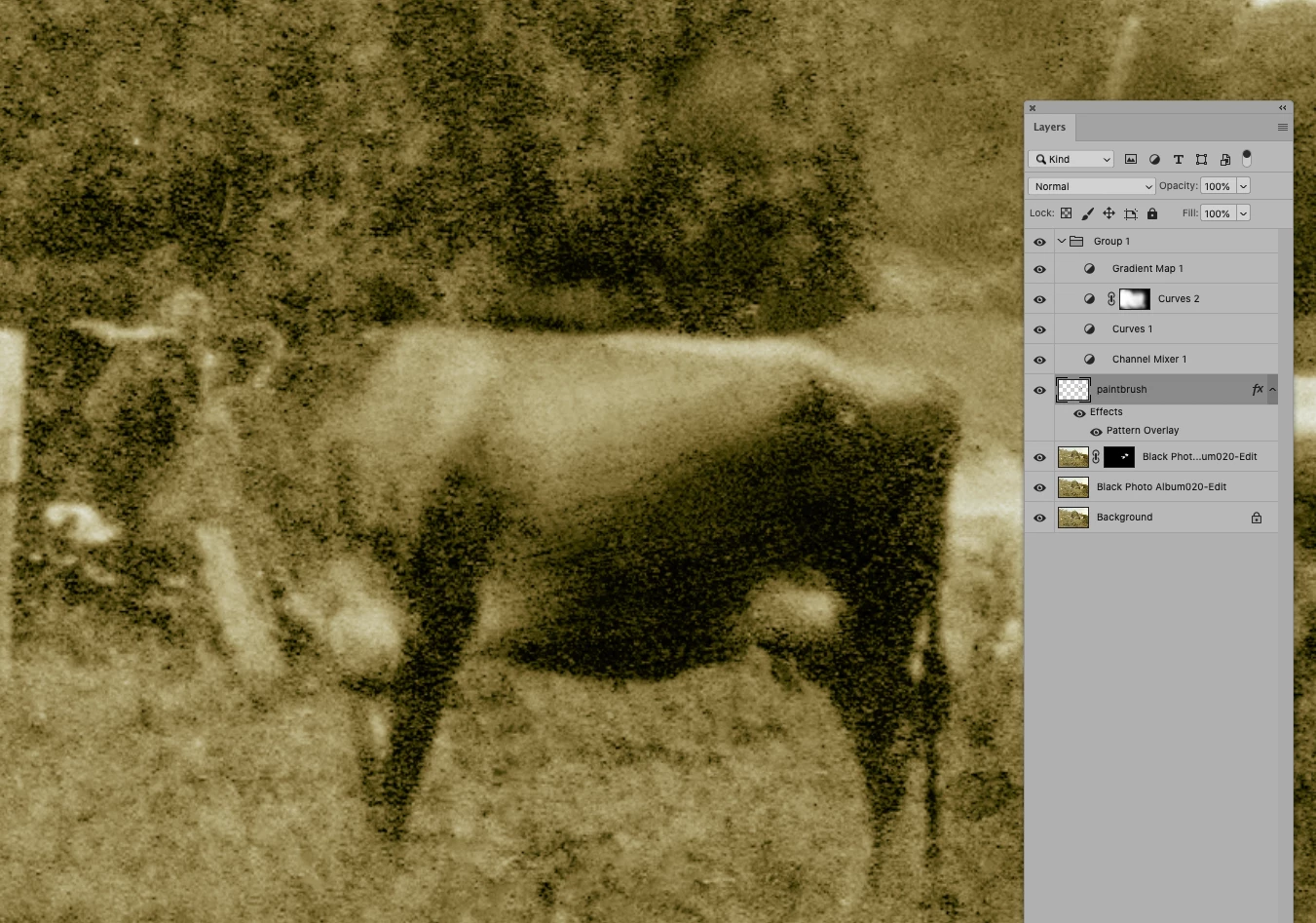

I think as the image is basically a tinted monochrome you may want to start by determining the least affected Channel and work from that with duplicates set to Darken or Lighten and painting on Layers with Linear Light Pattern Overlays.

Thanks for posting this. I am not familiar with this technique and have tried to follow your example. When I have all layers selected I only see a highly monochrome image. What pattern did you suggest and which layer are you painting on? Also, what have you done with the curves layers and gradient map layers. I think I need a more step by step description to truly follw what you have done.

c.pfaffenbichler
February 1, 2021
I painted on the Layer named »paintbrush« and the Pattern used in the Linear Light Pattern Overlay is a monochrome Add Noise on 50% Gray (and upsampled a little).
The Curves Layer edits the luminance and the Gradient Map Layer (set to Blend Mode Color) is used to colorize the monochrome image (which uses thhe blue channel for all three channels).
