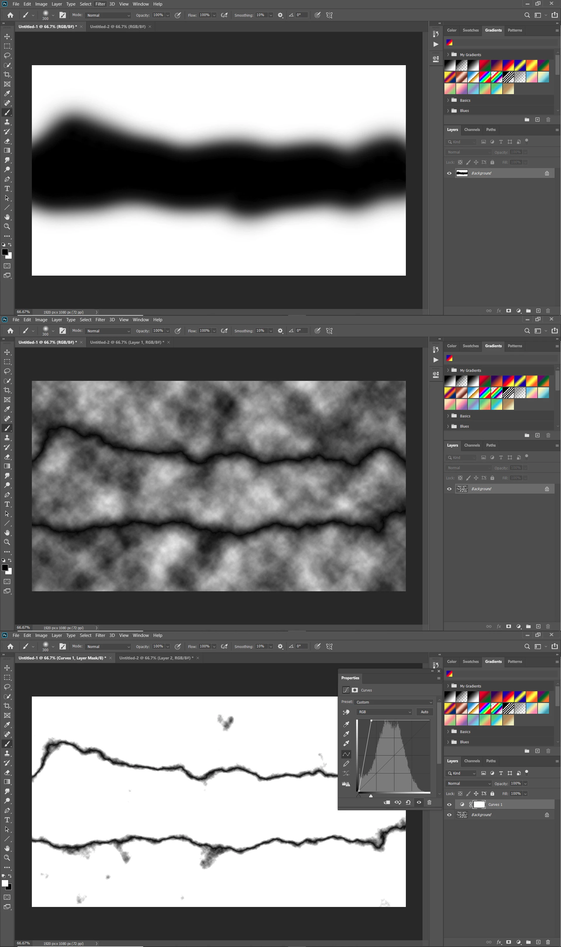

c.pfaffenbichler
October 4, 2019
Filter > Render > Clouds can be used to create a synthetic rough edge (see the two screenshots).

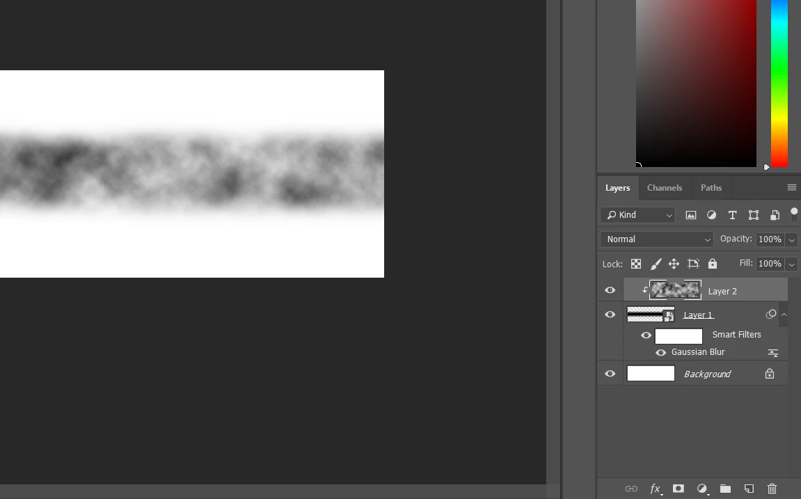

October 4, 2019
Thanks a lot. But there's a problem.Did I do something wrong?
c.pfaffenbichler
October 4, 2019
Try the Blend Mode »Hard Mix«.
