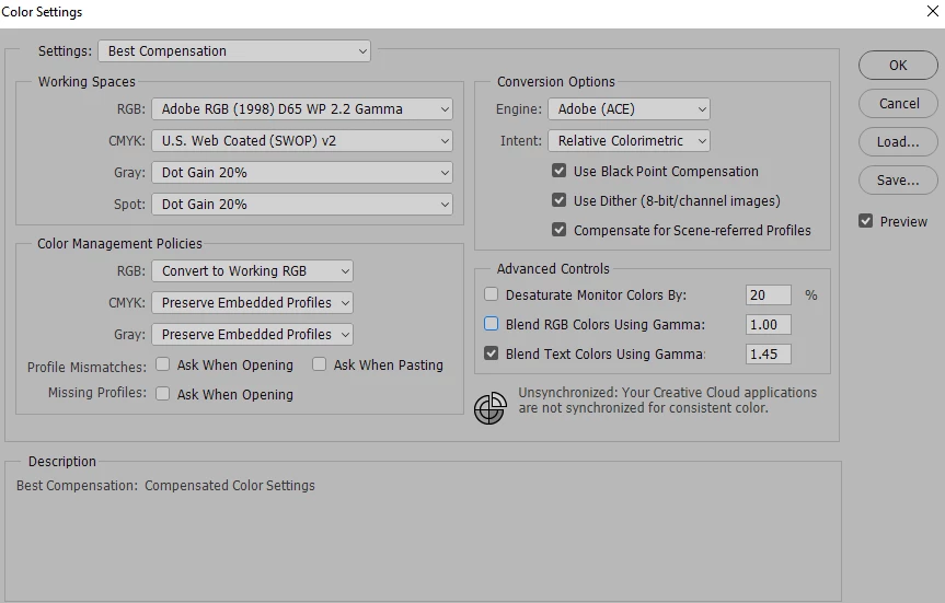

Which color profile should I use if the prints come out too dark?  I don't think the problem is in Photoshop because my 3 monitors have been calibrated. I have checked around to find out about the Output Color Profile but all looks like the settings are correct.  Here is a color panel showing the original and a scan of the printed.  The dark region is affecting the overall image where a bright red comes out like maroon.

D Fosse
November 27, 2016
No wonder. You have this as completely wrong as it's possible to get. You really need to stop everything you're doing and go back to the beginning. Reset everything to default settings and don't touch them until you understand what they do.
  • You don't use your monitor profile as document profile/working space. Ever. The document profile should always be a standard color space - sRGB, Adobe RGB (1998) or ProPhoto RGB.
  • Don't use "Convert to Working RGB"! Keep it at the default "Preserve Embedded Profiles": Any other setting is for special purposes where you understand the implications.
  • The monitor profile is set up at system level, by your calibrator, and you don't need to do anything more. Photoshop will find the profile by itself and use it to color manage your display.
  • The printer profile needs to be one specific for your printer, paper and ink combination. These profiles will be installed along your printer driver.
  • And finally - Adobe RGB gamma 1.4 - ??? Where on earth did you get that? Gamma 1.4 has no place in any of this. Throw that profile away. Again, use the correct printer/paper/ink profile.
Summing up: document profile, monitor profile and print profile are three different things and you can't mix them up like you do. And you can't "experiment" - each profile has to be the correct one. A profile is a description of a color space, and the description has to be correct for this to work.

JJMack
JJMackCommunity ExpertCorrect answer
November 27, 2016
Here you show Your Photoshop print setting you have it set so Photoshop managers colors.  There is also a Warning reminder to you to set your Printer Drivers not to manage colors.  You do not show your Printers settings.  You should show us them.  Also Normally you should use a printer/paper profile also when printing on paper not a standard color space profile.  The paper paper you use should be a high grade photo paper.  Also the print preview in your Photoshop dialog is not set to match print colors. So we have no idea of what you should expect the print to look like. There of course is not way you can show us your print. So I have no idea of what your thinking is with what you posted as your print colors. Your not showing us your print colors we would need to see your print.

November 27, 2016
Thank you JJMack, for your input.  I had just gone back to letting the printer handle the colors and I, again, used the proper paper and settings.  I think I got thrown off because printing to glossy photo paper was off and I watched several YouTube videos that had me trying a plethora of different settings.  In addition, the warning that comes up on the Print dialog made me wonder if I was getting the best match.  It turned out that it didn't.
Things are pretty much back to normal.  I turned settings back to the printer and reset everything.  They are a tad dark still but I will tweak it some as I go along. This chaotic episode is nothing compared to the "Three Day Why Won't It Print Black?" issue.  That was frustrating.
