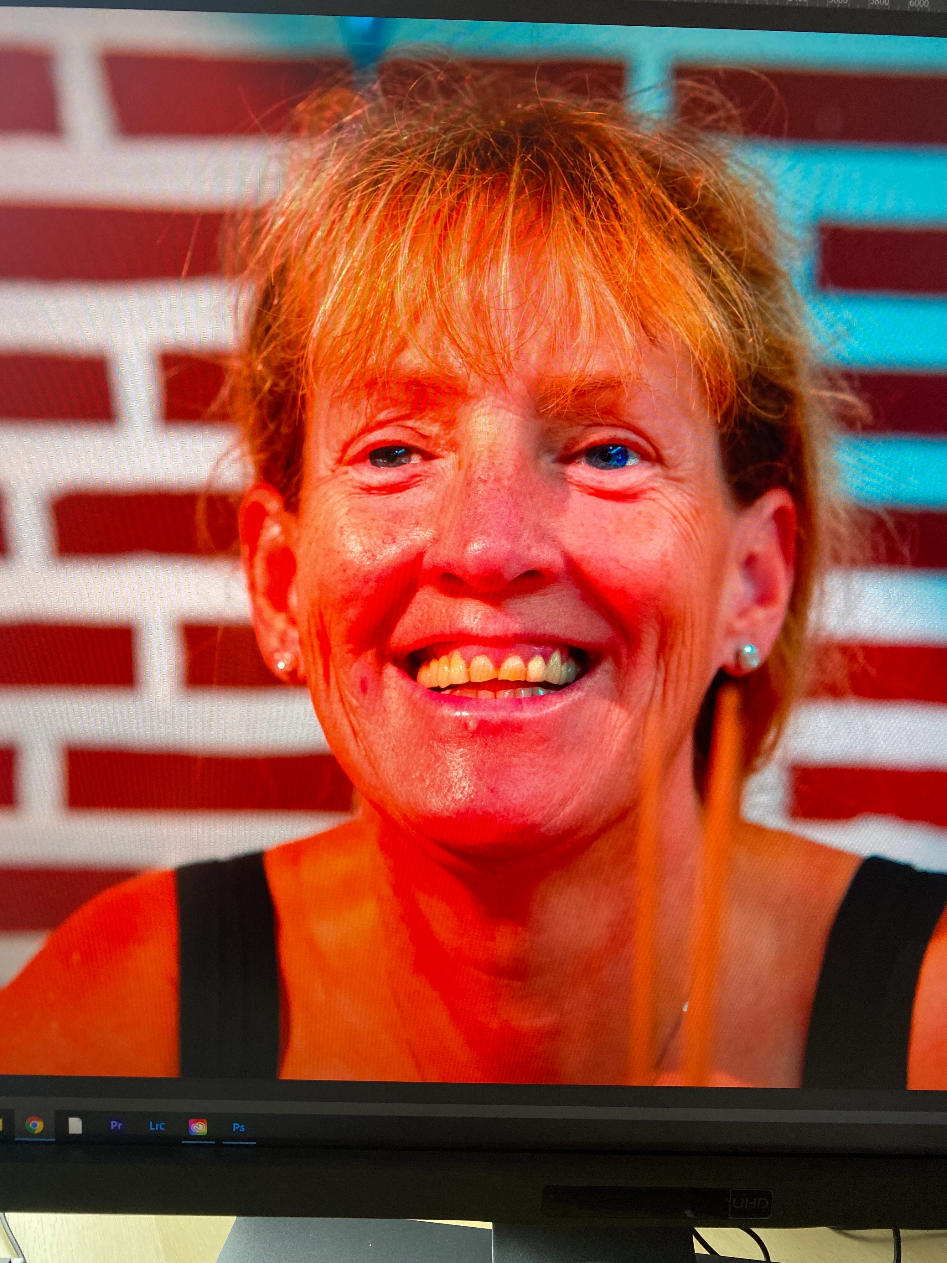

I ve just updated to PS 2021 but some pics processed with the last version are opening with excessive red tints mainly portraits anyone any ideas how to correct this

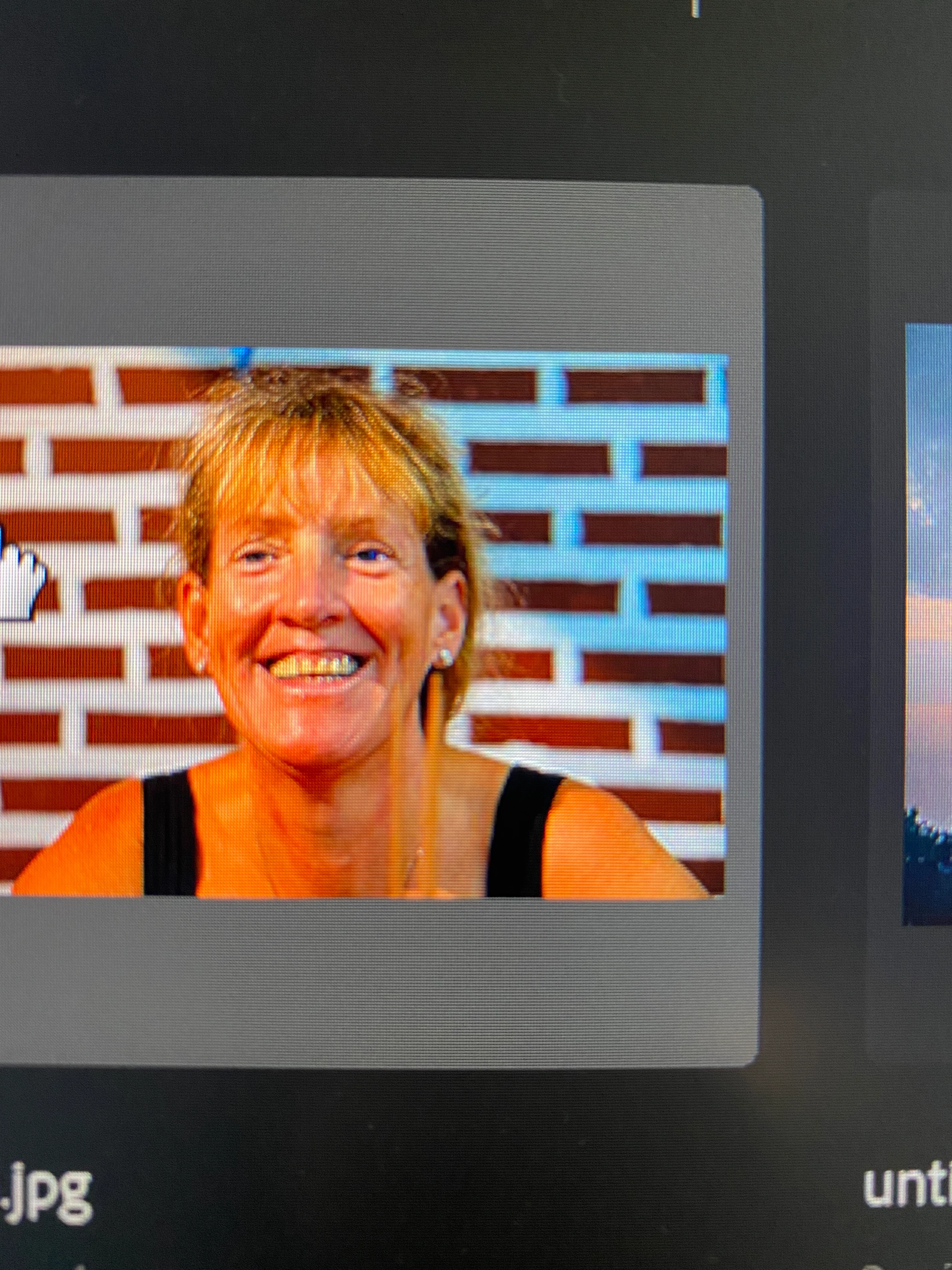

October 21, 2020
I took these from my phone on the home screen the picture looks normal, when i click on it to do some work i get the "red glaze"

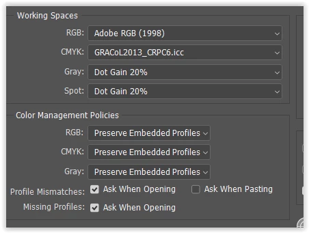

Perhaps you do not have notifications on when mismatched profiles occur. If you open a Srgb image while your RGB is set to Adobe 98 and you do not open as Srgb, the image will look redder.
Check to see if your "ask when opening" profile mismaches is checked:
Hope this is the problem with an easy fix.
HornedfoxAuthor
October 29, 2020
Thanks that helped a lot
