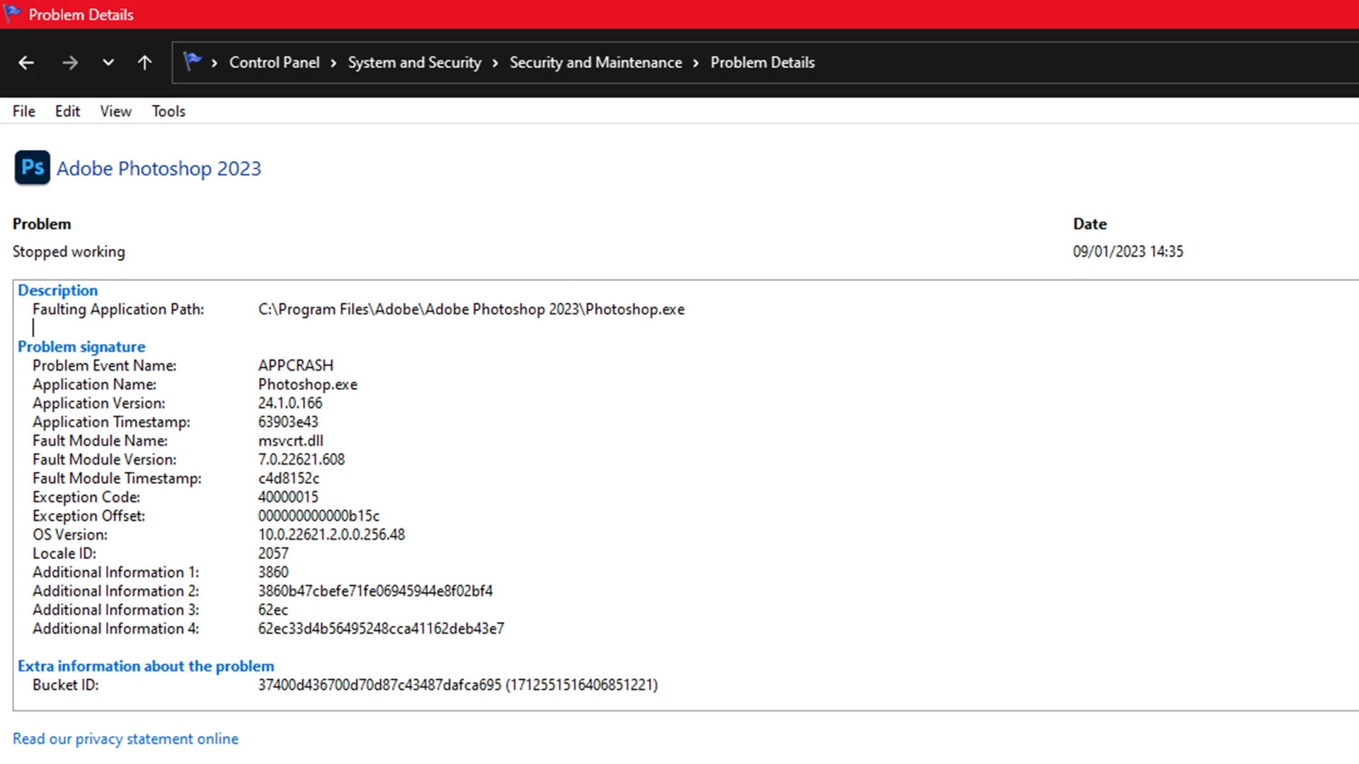

I have managed to find a log of the crash (Log attached) that might help solve this... Please help me I'm desperate for this to be fixed. Thank you

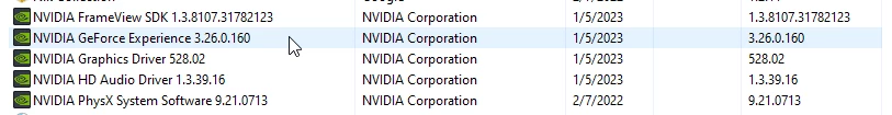

If you have a supported NVIDIA GPU, you can switch between the studio drivers and the gaming drivers any time you want. The easiest thing to do is make sure you have NVIDIA GeForce Experience installed on your PC. It might already be installed for your GeForce RTX 2070. Look in your Windows programs and features (see my screenshot below). Yours is an older card (2018?) so I don't know if it has the capability for switching. I am also not sure if dual switching causes any problems when running Photoshop, as I've never used it. Others here might have more guidance for you. You might want to contact NVIDIA or use their Support options first to make sure you are set up right. But you can download the latest studio driver from NVIDIA's website. Hope that's helpful!

Can you have both drivers on at the same time? And where would I find this Driver?

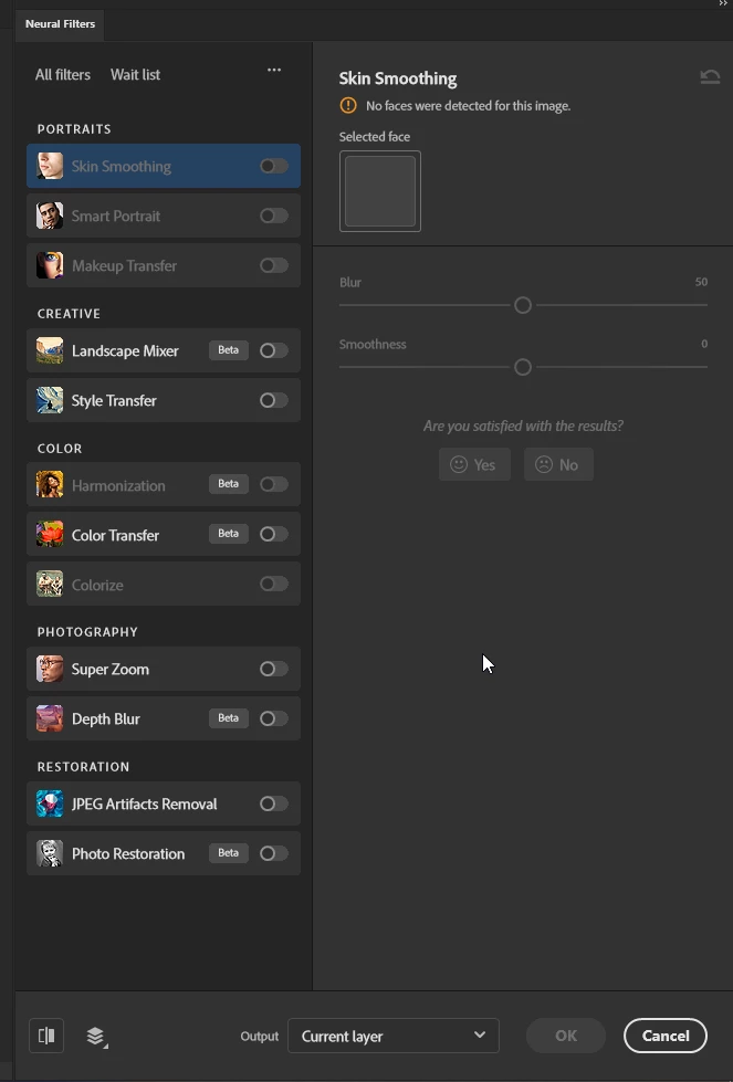

Okay, no worries, it's an easy mistake to make. There have been reports from some users that the Neural filters gave them problems, so you aren't alone in that. I'm still using Windows 10 with the 24.1 Release, and so far, all the Neural filters are working great. Do make sure you have installed the latest studio (not gaming) driver for your graphics card. A new one dropped on January 5. If you have an older card and system, there may be other adjustments in Preferences that will help. Please keep us posted.

Silly me yes Neural filters is what I am on about. Something has not been right since the crash caused by them.

Do you mean the Neural filters? Or are Natural filters something else you installed?

I personally believe it has something to do with Natural filters as it all started from that. Theres no way I can find to uninstall the filters i downloaded off the cloud which would give me a start on where to look.

Okay, thank you, that extra info helps. Since the Neural filters use processing in the cloud, it's possible you ran into some configuration issues there, which is why I asked about OneDrive (or Dropbox, for that matter). If you have time to try this now, roll back one version of Photoshop to see if you are stable there. From the Creative Cloud desktop app, click on the three dot menu and select earlier versions.

My crash log mentions a msvcrt.dll but on my entire pc photoshop is the only software I have a issue with.
