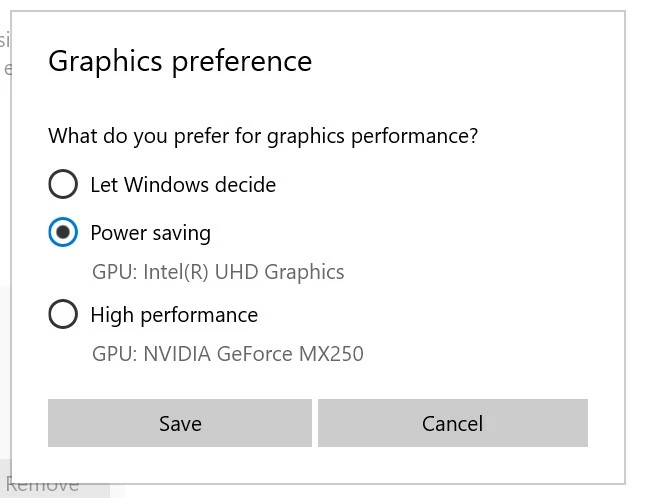

Thanks. I updated to the latest drivers through Dell (as my machine's recommended OEM) - and managed to open Photoshop by changing the graphics preference to Power saving - trying the High performance option didn't work - as per the screenshot below. While I can open Photoshop, it's telling me that my graphics drivers are incompatible, but I'm not sure what I now need to do to get this working properly. I've been a Photoshop user for 20+ years, and this is the first time I've ever had an issue like this.
