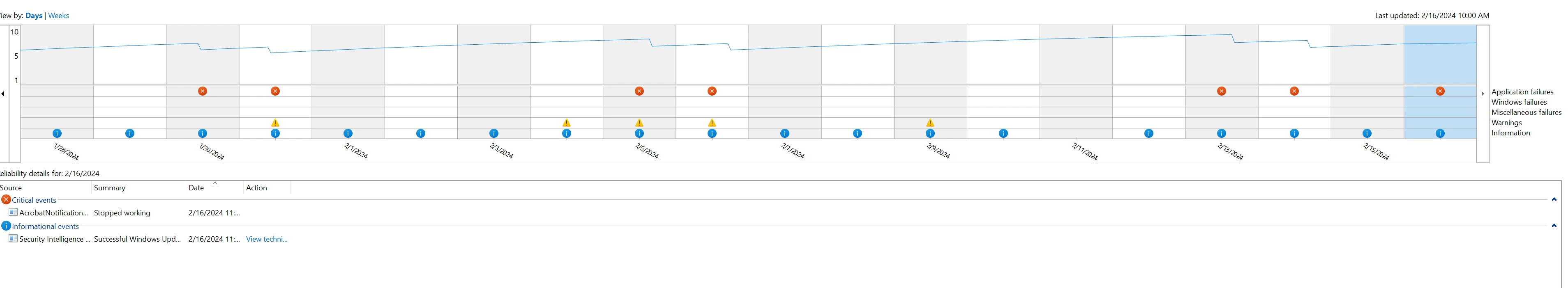

While taking some screen shots of my backup system today I noticed there are some errors. Some of these was caused by disabling some services intentionally while testing. There is a Stop Error on 16 Feb. IOT to find the cause liik below the timeline, Shows AcrobatNotification Stopped working. Provides the path where the file is located. In order to deep dive the concern double click the path here. This provides additional information on the Error.

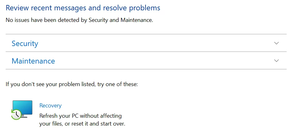

To get to the Reliability Monitor you access through Control Panel/Security and Maintenance/Maintenance/
Click on View Reliability History
You should see the screens from there.

February 16, 2024
Will help you pursue this later today. Have some business to take care of first. In the interim run Windows Reliability Monitor to see if this will show you errors. When I have had Illustrator Stop errors in the past they show in Windows/Applications Logs. As I recall you are running a laptop? As I mentioned in previous post I am not a fan of running recent releases of PS. I am still on an older version of PS on my laptop which has an the Intel 11th i5-11400H @ 2.70GHz, 2688 Mhz, 6 Core(s), 12 Logical Processor(s). Yes, couple years old. Bought it to tether and work on images on the road.
