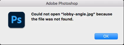

I'm running Photoshop 21.2.4 (after today's update) on a mac running macOS High Sierra V 10.13.6. Ever since today's update, I receive an error message stating: Could not open "filename.jpg" because the file was not found.
I see a message in the creative cloud interface stating that the latest version of photoshop (V22.0) is not compatible with my OS, so it doesn't / cant update.
After researching the forums, it seems like a possible solution is disabling the Graphics Processor - which I tried, but it did nothing. Another suggestion I've seen is that Camera Raw might be the problem. Camera Raw DID update to v 13.0 according to the CC interface, however, when I try to access it's preferences through photoshop, I see the message "Could not complete the Camera Raw command because the file was not found". I'm guessign the two problems may be linked, but I'm not sure how to resolve the issue?

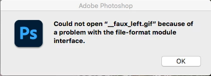

It seems .jpg's are the only affected file types, .psd open fine, as do .eps, .tif, .png etc. however .gif's throw the error "Could not open Filename because of a problem with the file-format module interface.
I have a co-worker with an identical system who has not performed any updates yet who is having no problems, and I was working on the same files just fine prior to the update, so I do not think this is related to my system or the image files I'm working with.
Any help is greatly appreciated.

To any others suffering this problem, emilio rescigno from Italy had the solution to this problem, here are his own words (translated):
I've just post the solution. I try to translate from Italian.
To solve the problem proceed as follows:
1) go to the link download in the my previuous post
2) so download version 12.2.1 of raw camera - install it.
3) restart photoshop
everything will now work properly. the problem is given by the incompatibility of raw camera 13 with the new versions of photoshop and lightroom . This is because the Mac OS HIGHT Sierra 10.13.6 operating system is no longer compatible with future raw camera versions. You need OS version 10.14 and later. Ergo: you will need to change your computer. I hope I have been useful.
The previous version 12.2.1 will replace the newer version. Do not delete folders or anything else.
Remember to go then to app store and disable automatic updates otherwise you'll be back to the next update.
And lastly, here is the download link in English so you can read Adobe's instructions (be sure to grab 12.2.1 installer if you're using the same OS as I am!):
https://helpx.adobe.com/camera-raw/kb/camera-raw-plug-in-installer.html
Good luck!
