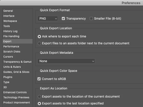

November 1, 2021
Pro-PhotoRGB tagged images will wash out in an sRGB space. It's not a destination profile but an editing profile.
I'd suggest converting from Pro-Photo to sRGB. In fact use the Export feature in Photoshop and these settings:  Then export your Pro Photo tiff as an sRGB png preserving your colors.
File > Export As... or Quick Export as PNG  You'll have both the Pro-Photo original and a sRGB copy.
