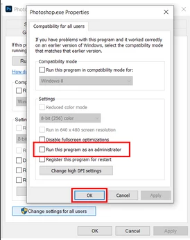

It could be a permissions issue with Photoshop accessing the required folder, do you have to run Photoshop from a different Admin account, or do you refer to the right click & 'Run as Administrator' process?
If it is the latter, please try the following and let us know if it helps.
  • In the Creative Cloud app, press CTRL + ALT + T to launch Creative Cloud Troubleshooter & select 'Close Creative Cloud and related processes' > click on Go.
  • Go to C:\Program Files\Adobe\Adobe Photoshop 2022
  • Right-click on Photoshop.exe > Properties > Compatibility > Change Settings for all users > Check 'Run this program as an administraor'
  • Click on OK & Apply to save the changes.
  • Go to C:\Program Files (x86)\Adobe\Adobe Creative Cloud\ACC
  • Right-click on Creative Cloud.exe > Properties > Compatibility > Change Settings for all users > Check 'Run this program as an administrator'
  • Restart the computer.
Let us know if this helps.
Thanks.

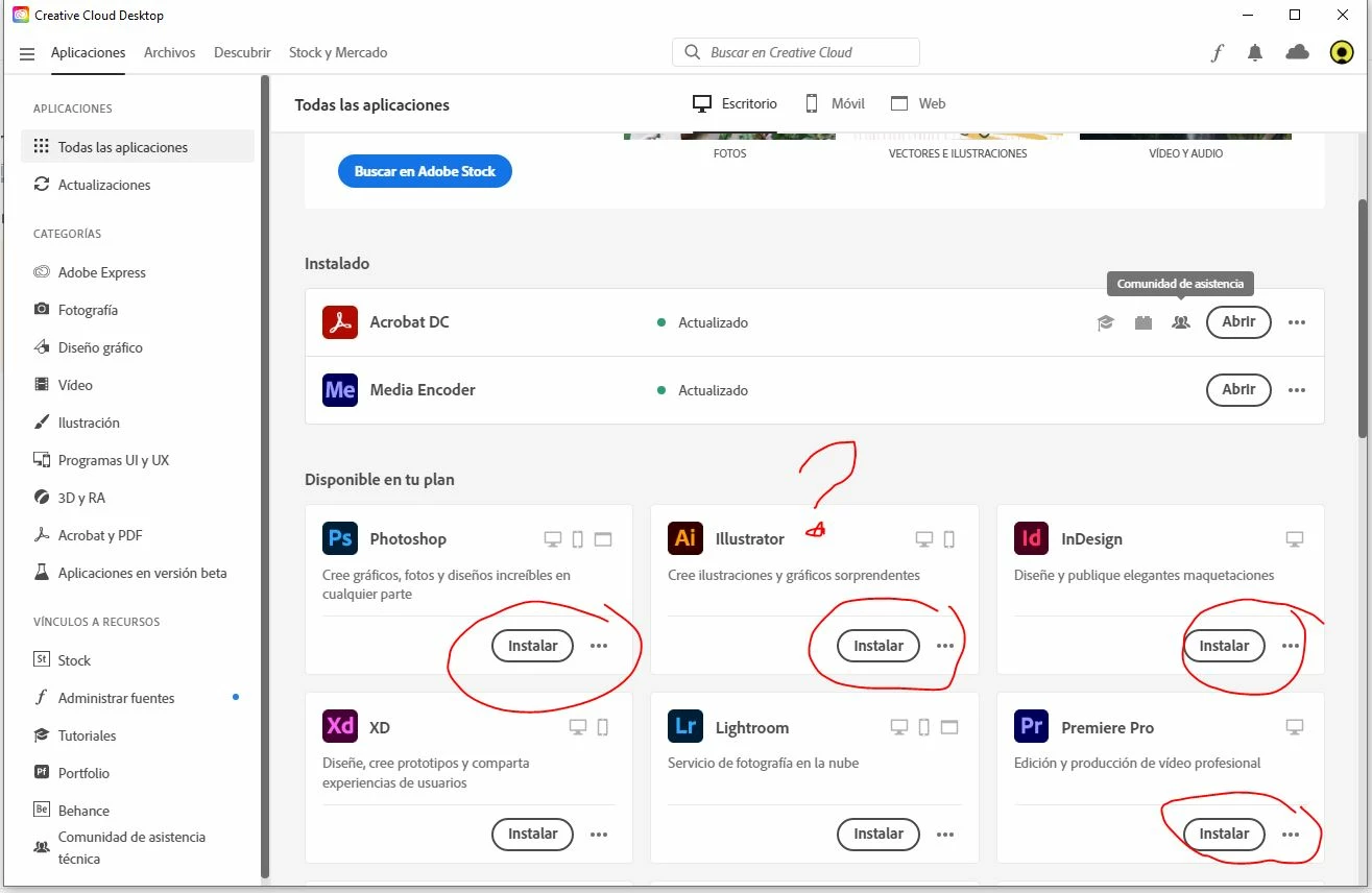

Mi Sistema Operativo es Windows 10 en un equipo de sobremesa. He seguido todas las instrucciones, he reinstalado Photoshop y aplicado los permisos y entonces Creative Cloud ha dejado de funcionar. He vuelto a reinstalar Creative Cloud y ahora funciona Photoshop, PERO NO APARECEN los programas que tengo instalados en Creative Cloud Desktop (aparecen como si no estuviesen instalados). Agradezco tu ayuda si puedes hacer algo para que esto funcione bien otra vez.

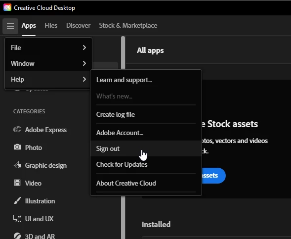

Try signing out of the Creative Cloud app and signing back in again
