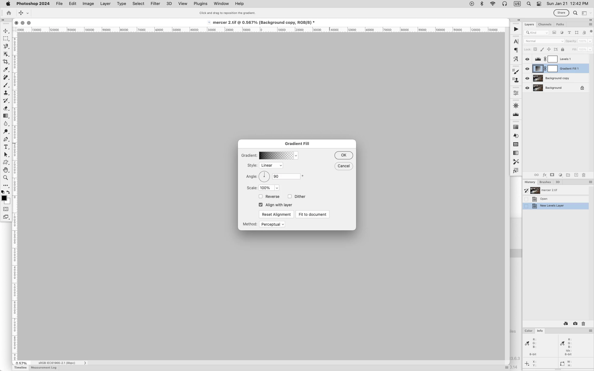

January 22, 2024

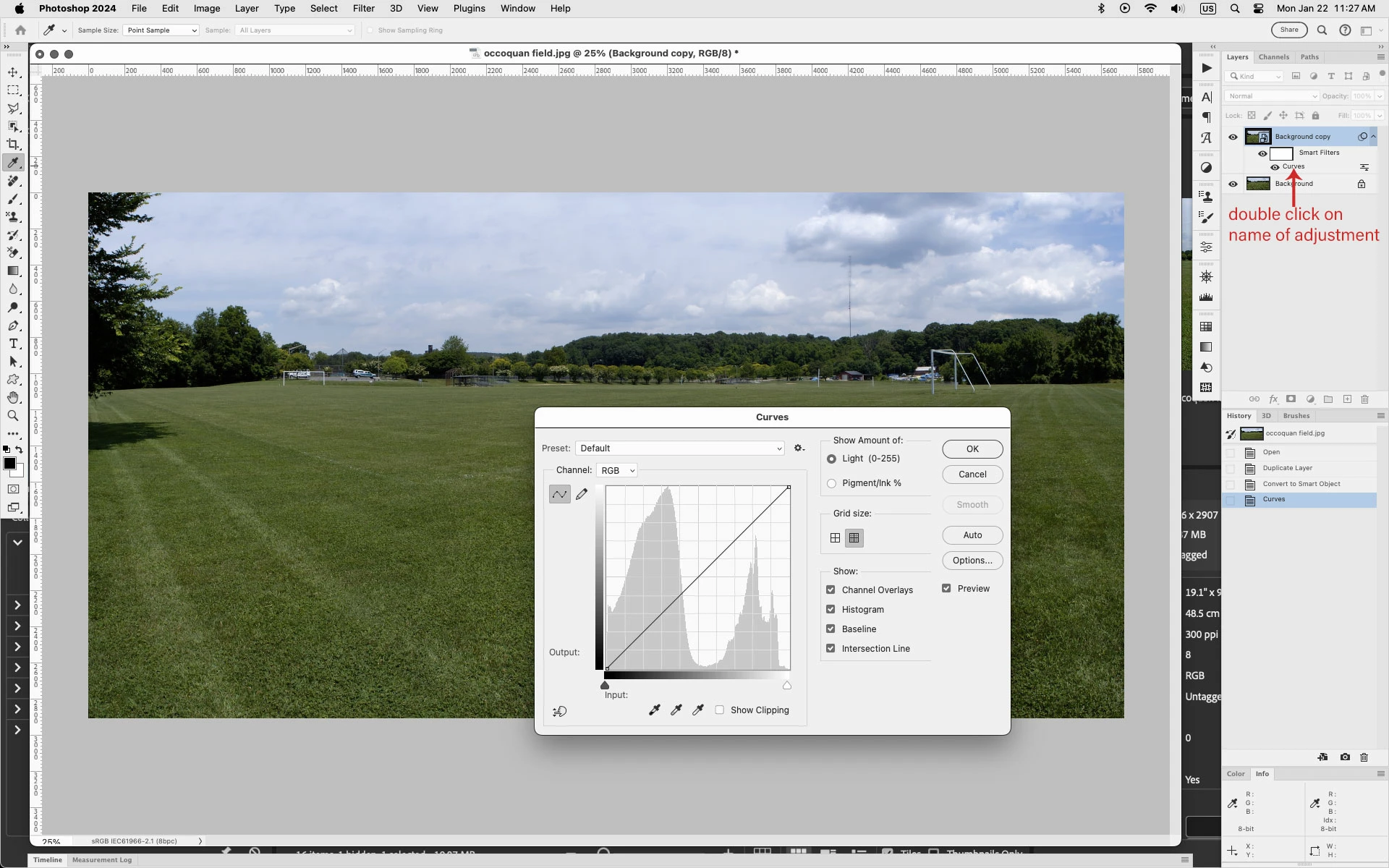

Unless you had an action or plugin panel that initiated floating adjustments layers, photoshop has had the adjustment controls in a panel since photoshop cs4.
You can get the floating dialogs if you go to Window>Adjustments and Option/Alt click on the Adjustment icons.
Or turn a layer into a Smart Object and use Image>Adjustments as a Smart Filter.
To reopen the Floating Adjustment dialog double click on the name of the adjustment

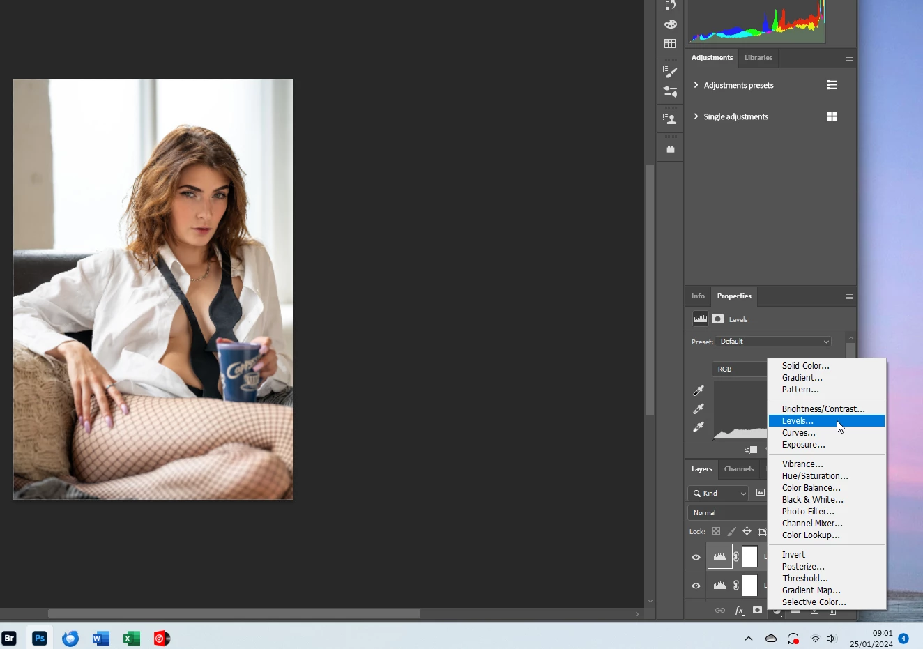

January 25, 2024
I don't know - floating dialogues have been the default for me since CS3.  Never did anything cause them.  Then they just stopped.
And, yes, thanks, I can go via Window>Adjustments and Option/Alt click.  But this pops the layer info into the panel, and the floating window can't be activated by double-clicking the adjustment layer icon.
Ordinarily I'd have clicked bottom right as per screenshot and the floating dialogue would pop up when the layer iconm was double-clicked.  This was, as far as I know, behaviour straight out of the box.

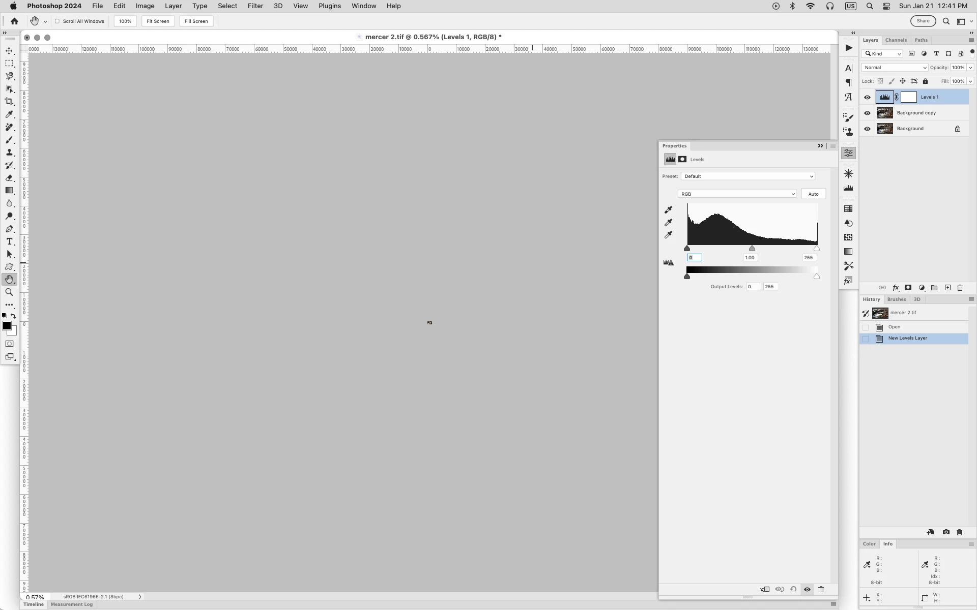

You have the Properties panel already showing which is where the adjustment controls are for Adjustment Layers.
If you create a Layer>New Fill Layer, then you should get a floating dialog with the adjustment controls.

January 21, 2024
No double click on the Adjustment Layer thumbnail in the layers panel.
For example, double click on the Levels icon  in the Layers panel.
Can you post a screenshot of what you see after doing that?
The adjustment controls are displayed in the Properties panel when using Layer>New Adjustment Layer
Window>Properties
Layer>New Fill Layer should display floating dialog with the adjustment controls
Fill Layer floating dialog for adjustment controls
Adjustment Layer controls are in the Properties panel

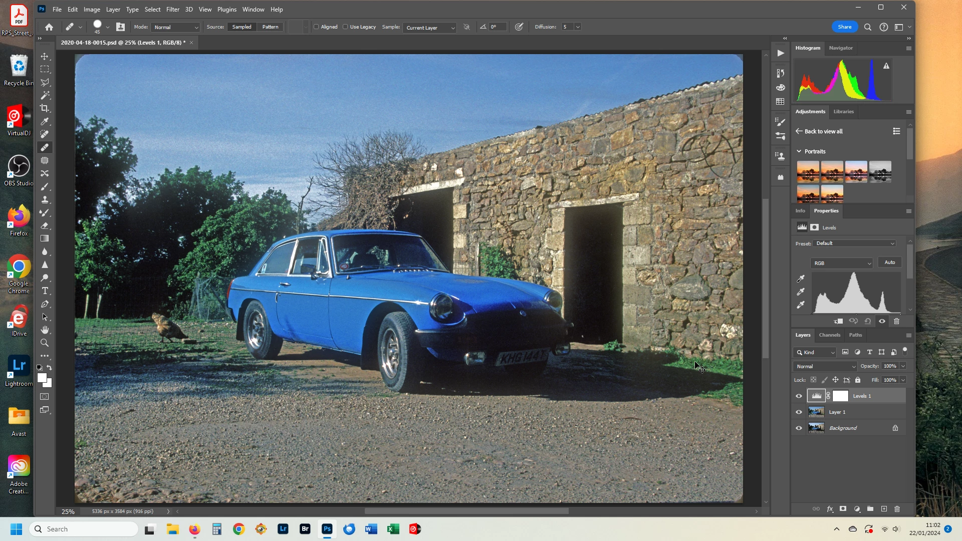

January 22, 2024
This is what I get - i.e. nothing.
