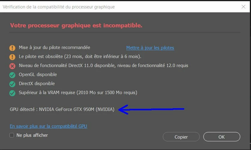

The card is detected, but it's not supported.
Photoshop now requires DirectX feature level 12.0, but your GPU only has feature level 11.0.
The feature level is a measure of the card's actual physical capabilities, what it can do. It's a hardware requirement, not a software requirement. This is not something you can update to.
This requirement has been in force some time, I believe before version 22. So I think you would need to go further back in Photoshop history to find a PS version that worked with that GPU.

As I had uninstalled Photoshop 22.2 : before to select dedicated graphic card for Phostoshop and Sniffer, I had installed the last version of Photoshop (25.9).
The result : by opening Photoshop, we can see at the blue arrow that the Nvidia graphic card is detected for Photoshop :
I have also gone in Photoshop/Preferences/General and selected "Reset preferences on quit". So now, the preferences are reset.

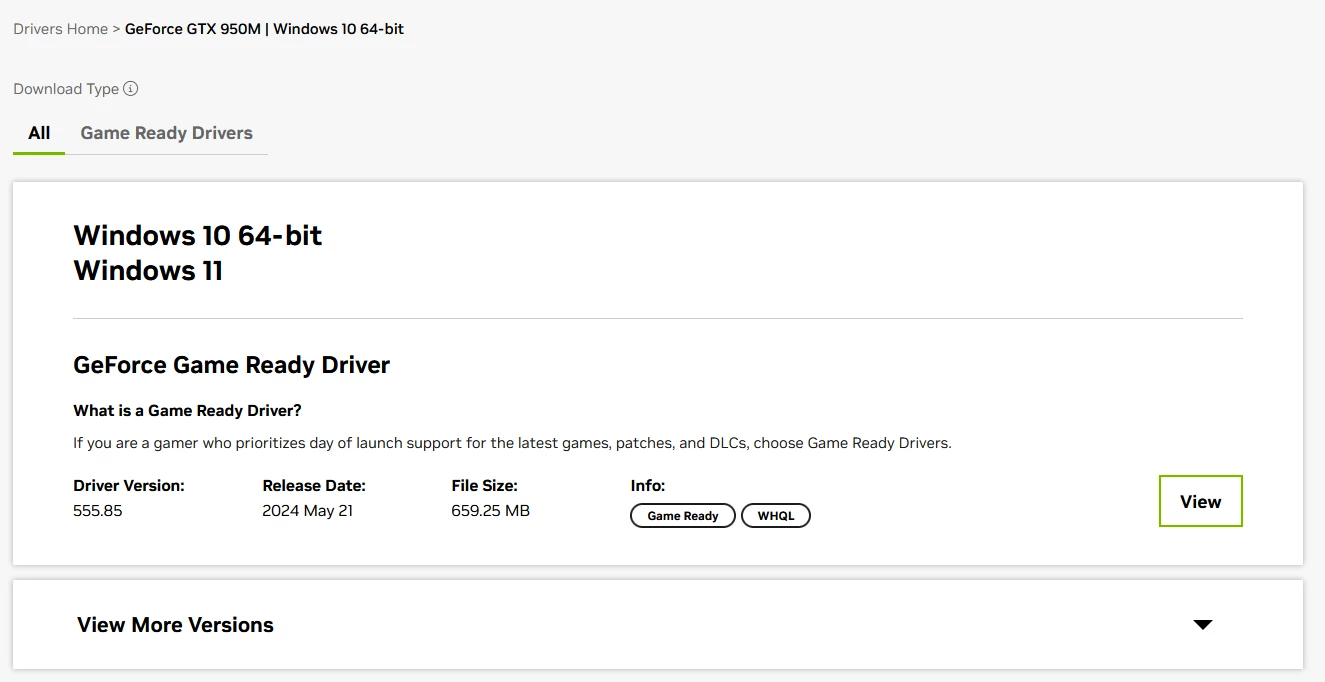

@pierret18811376 did you check the Nvidia site for the GPU driver
https://www.nvidia.com/download/driverResults.aspx/224749/en-us/
When installing, go to Custom > Advanced and then select "perform a clean installation"
