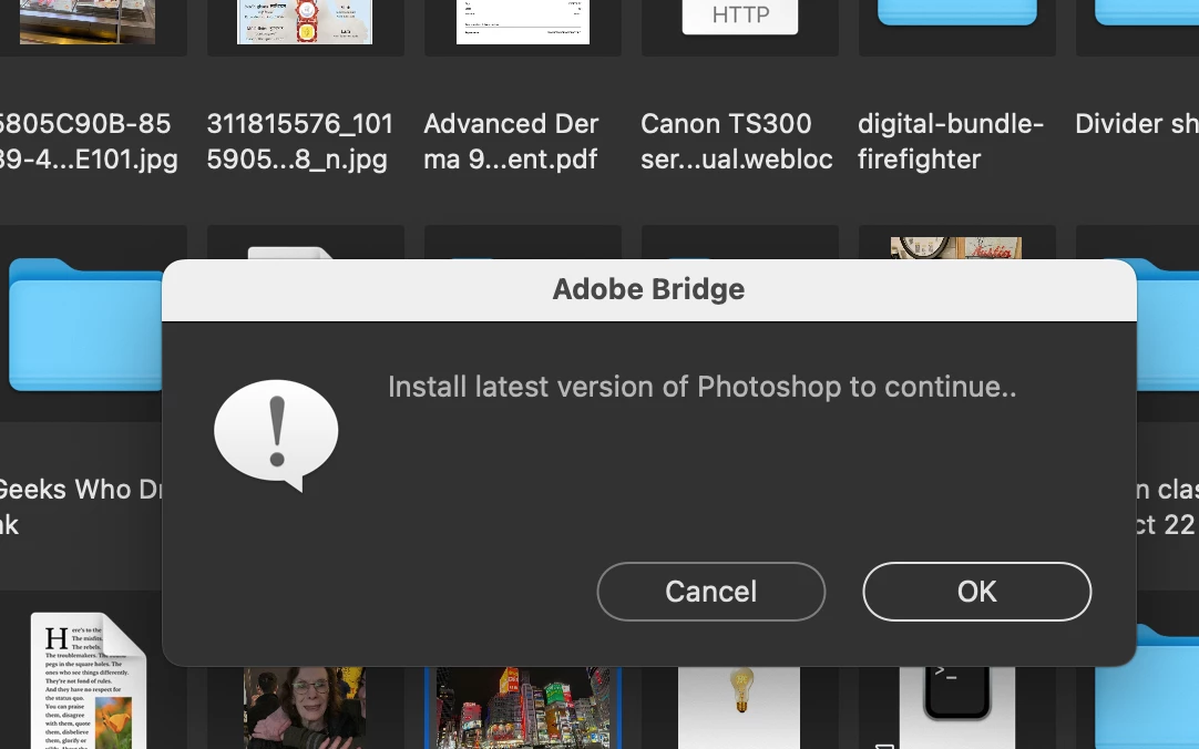

1) Bridge would not allow a Photoshop alignment of 2 photos until I "upgraded" Photoshop.
2) I upgraded Photoshop to 24.2.0 and Bridge still said I had to upgrade for Bridge to work.
3) I upgraded Bridge as well, and then I rebooted.
4) Attached a screenshot of the Bridge error. Now I know why this is an error. I had the 2022 Bridge open. When I opened 2023 Bridge voila, the ability to photomerge into Photoshop NO LONGER EXISTS. I guess this is because Photoshop has "auto-align" in it now, but IT NEVER WORKS.

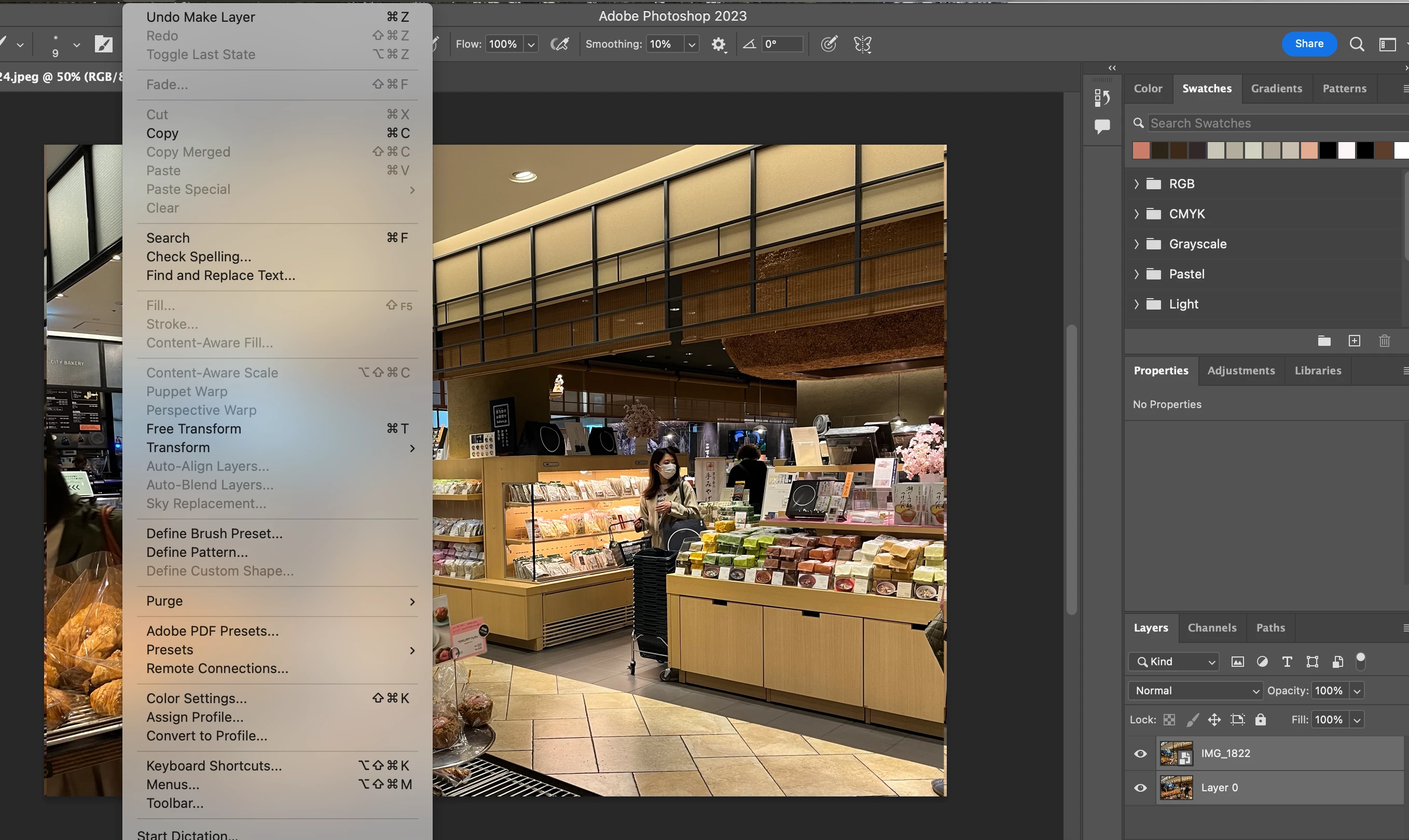

Hi @Marly5E9A you can't auto align with a smart object layer.
D Fosse
March 18, 2023
One of your layers is a smart object. Rasterize it, and it'll work.

@Kevin Stohlmeyer This is what I see every time I try...

Marly5E9A작성자
March 13, 2023
Hi kevin, that's a great suggestion so I tried it. Screenshot attached
showing the 2 unlccked layers, yet it's still greyed out...
p.s. I really appreciate your help on this 🙂 Any other ideas?
[image: Screenshot 2023-03-13 at 7.29.17 PM.png]

When I select 2 layers and try to run auto-align that option is greyed out.
No error message, just not able to do the action. And the 2 pictures are
very similar, 2 pics I took on iPhone that are the same with just a little
extra on one side or the other I'd like to combine. Bridge used to be how I
did it, but that functionality is gone so doing in Photoshop is the only
option.
