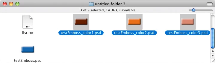

For example:
I have a txt-file with this text:
color1;20;30;40;
color2;60;70;80;
color3;60;50;40;
and a file »testEmboss-psd« open and active in Photoshop with a top-level (meaning it is not in a Group) Solid Color Layer with the name »colorLayer«; the Script at the bottom will get me these:

c.pfaffenbichler
February 18, 2012
Could you please post screenshots/mock-ups to illustrate what you are trying to achieve.
